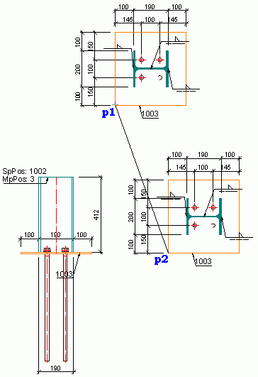

Move a view
- Open the detail drawing.
- In Labels & Dimensions tab
Parametric Views panel, click
(Move view).
- Select the view to move.
- Select the reference point for the view (P1).
- Select the second point (P2).
The selected view is moved to a new location, determined by the position relative to the reference point and the distance and direction determined by the two points.
