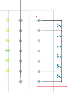

- All holes in the hole pattern - All holes can be dimensioned with a single dimension line, and during update the points will be retained:

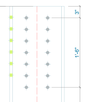

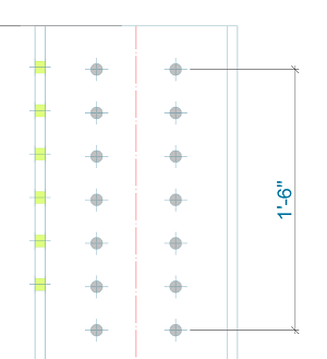

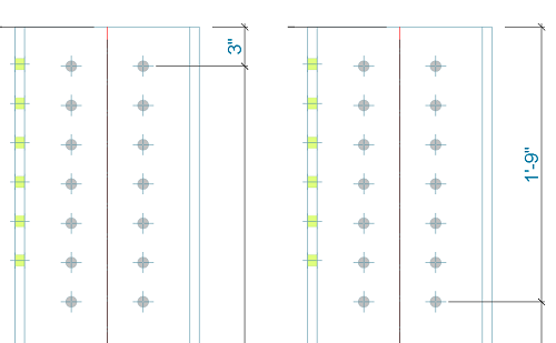

- First / Last / First and last points.
- First point / end point together with a reference point:
- First point + end point:
- First point + end point + reference point:
All cases presented above will behave as expected during update - the points will be valid smart dimension points; they will update if the hole pattern is moved or if the spacing is changed (leading to a different relative position between holes).
When the number of holes along the dimension direction changes (you add or remove holes), the behavior is the following:
- For cases where you only dimension the first, last or both the first and last points of the pattern, there will be no change in the dimensions. The dimension will adjust if those holes change position.
- If the dimension line is created on all the holes in the pattern, as seen in the first example, then when you add or remove holes from the pattern, the dimension will adjust removing or adding points. After the update, the result will be one dimension on all the holes (even on the holes added from the 3D model). In the image on the right, the hole pattern was changed from 7 holes to 5 holes:
