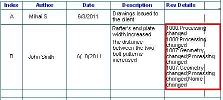

Index A letter or a number identifying the revision level.
Author and Date The name of the author who has worked on the model and the time work was done on the model.
Description The description of all changes made during a revision level.
Rev Details Some revision tables may contain the Rev Details column. Advance Steel will automatically complete this column with a generic description of the changes on the drawing.
