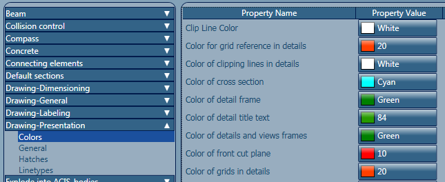

When you create drawings, the color for objects is based on a set of user controlled defaults, instead of layers as done in modeling. The layers in the prototypes are not relevant to the configuration, placing different objects with no influence to how the objects are drawn, such as color, line-type, and visibility.
Single Part and Assembly Drawing Colors
For all single part and assembly drawings, the color of the objects is based on line type. The same color is used for the visible lines of any object, without differentiating between beams, plates or bolts. These colors are specified in the Management Tools application, under the Drawing-Presentation/Colors category. You can specify colors before or after the drawing is created. Updating the drawings will always use the current setting of the color defaults:
