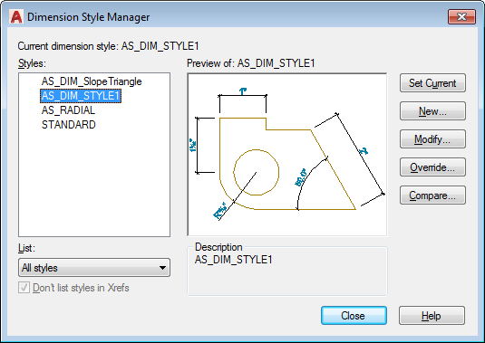

  1. Access the AutoCAD Dimension Style Manager dialog, using the Advance Steel (Change dimension style) command, located on the Labels & Dimensions tab Parametric Dimensions panel.
  2. The Dimension Style Manager dialog appears:
  3. Create or rename a dimension style. The names set here will be further used in configuring the default values in the Management Tools application.
  4. Using the Modify... button, configure the selected dimension style with the required settings (color, alternative units, etc).
  5. Close the dialog to save the settings.

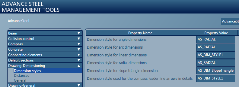

Management Tools Defaults for Dimension Styles
Change the defaults to match the dimension styles from the prototype definition. They are all located under Drawing-Dimensioning Dimension styles. Each different type of dimension (linear, arc, radial, angle and slope triangle) has its own dimension style specific default value. Multiple dimension types can use the same dimension style:
