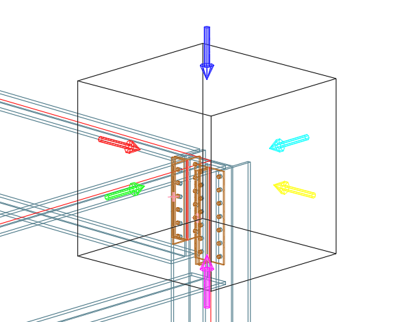

A difference between how cameras set the view box - how much of the model it details, and how the model view isolates certain portions of the model, consists in how the clipping planes of the box act.
For model views the clipping planes are fully independent, and each one can be individually activated or deactivated. The camera detailing view box is more restrictive, with the x0y view box being either automatic or limited. To keep consistency between the two, the model view clipping planes behavior was modified for when the model view has the camera functionality active.
When the camera detailing functionality is disabled for model views, the six clipping planes from the Model view dialog
Clipping tab, work independently from one another, controlling the 3D model isolation capabilities for the model view.
When the camera detailing functionality is enabled, the active and inactive state of clipping planes in the Model view dialog
Clipping tab, change to match the detailing necessities:
- The Rear clipping option can only be active if the Front clipping option is also active. Therefore, the front and rear clipping planes (the depth settings for the camera) only work in three cases: both active, both inactive, and only front active.
- The xOy viewport (top, right, bottom, and left clipping planes): you can only activate all or none of the clipping planes. This represents the automatic or fixed camera viewport settings.
Together with the clipping planes, the view box definition is also controlled by the box itself. Using a fixed view box, with checked clipping planes triggers the model view camera detailing to use the model view box as a reference. Changing the box size in the model will trigger an update of the camera view box, allowing you to add objects to the camera detail or remove objects from the camera detail.
