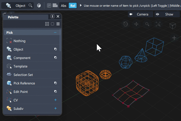

Pick Nothing
Use Pick Nothing to ensure that no objects in the scene are selected, for example:
  • Use Pick Nothing after other Pick tools have been used to deselect everything.
  • Use Pick Nothing before using a modelling or editing tool. This ensures that there are no objects out of view accidentally selected, in which they would be inadvertently affected by the tool.
  • Use Pick Nothing as a shortcut for Next in the tool workflow.
Note: Pick Nothing is a momentary tool, which means that when used, it is applied momentarily, but doesn't persist, and the previous tool used becomes the current tool again.
Access the tool from the Pick Palette or from the default LMB Marking Menu:

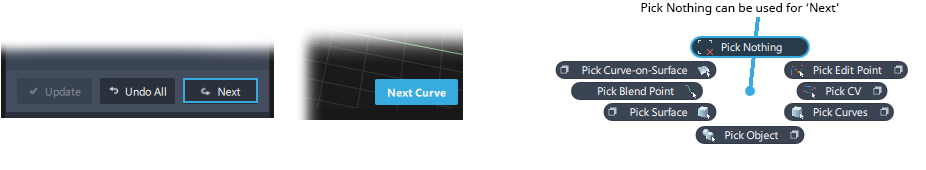

Pick Nothing used for Next function in tools
In many tools, there is a Next button in the Control Window that ends one operation of the tool and begins the next (or a button in the model window).
Pick Nothing has the same effect as the Next button.
