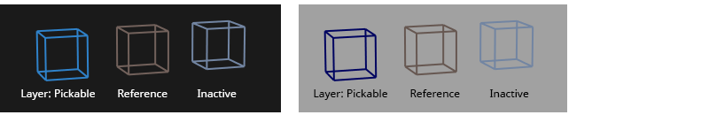

Note: Templated objects are similar to items on layers set to the Inactive state. Both techniques are useful:
  • Use templating for individual objects regardless of layer assignment. Templating is often used to temporarily make selection easier, such as when geometry is overlapping.
  • Use layer states to disable groups of geometry on a layer. Layer states are typically used once the model geometry is well organized to control the display and selection of collated geometry (see Set State).
The layer states have different screen colors so they are distinguishable from the templated state:

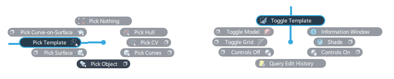

Improve the template workflow using hotkeys or marking menus
To use the template workflow effectively, the following three tools are typically be assigned to a Marking Menu or to hotkeys for quick access:
  • Pick Object
  • Pick Template
  • Display > Template
