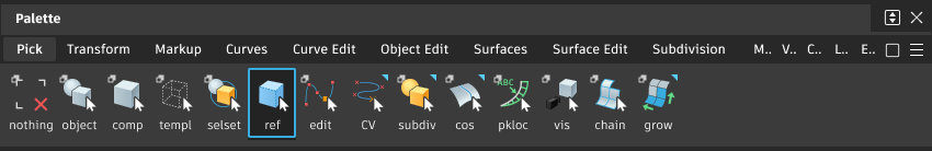

Use this tool to pick or unpick entities that are part of a reference file. Reference objects cannot be selected in the viewport using any other Pick tool such Pick Object.
You can specify which entities of the reference to pick, including objects, alternatives, groups or layers, as well as the reference file itself (all entities).
Access this tool from the Pick palette:
