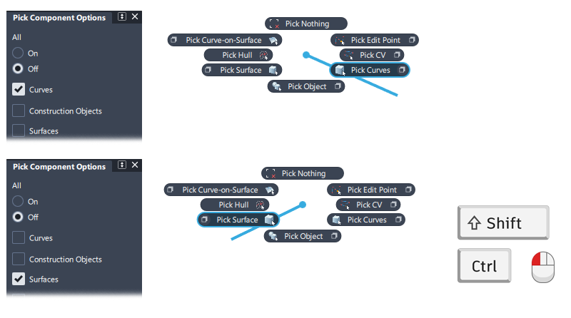

- As a pick filter to select particular types of items by setting the Pick Component options. For example, Pick Curve and Pick surface on the default Marking Menus are instances of the Pick Component tool.

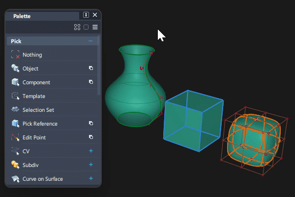

Access this tool from the Pick palette:

Pick Component workflows
Marking Menu Pick tools
Pick Component is used twice in the default marking menus for Pick Curves and Pick Surfaces:

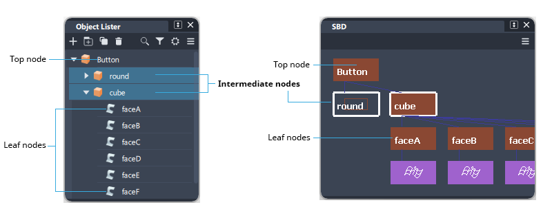

Selection and the node hierarchy
The example below shows a group node hierarchy with three levels.
The hierarchy starts with a grouped object - the cube. Next, are the created round surfaces, which are also a group. These objects represent intermediate nodes in the hierarchy. At the top-level, the intermediate nodes are grouped together to form a single node, renamed to Button.
In the scene:
Pick Object always selects the top node of a group hierarchy.
Pick Component always selects the leaf node at the lowest level of a grouped object.
Pick Component cannot be used to select intermediate nodes in the scene. Instead, use the Object Lister window or the SBD window and use Pick Object or Pick Component on the nodes:
