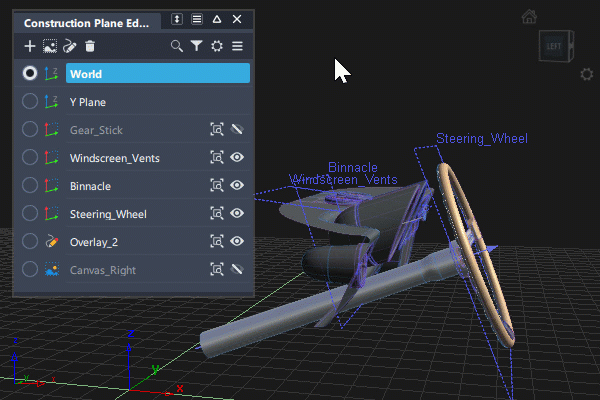

Construction Plane Editor
The Construction Plane Editor lists all construction planes in your file and provides quick-access tools for managing and using planes.
Construction planes allow you to temporarily use a separate coordinate system that can be arbitrarily oriented with respect to the world space coordinate system. This is particularly useful when you are modeling at different angles.
Canvas planes and markup planes are also listed in Construction Plane Editor as they use the same plane structure. Note that specific lister windows are also available for these two plane types : Canvas Lister, Markup Lister.

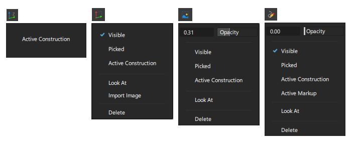

List Item tools
- Set Current Construction Plane - Sets the selected plane as the current construction plane. The plane name highlights, and only one can be set at any time. Selecting the set icon a second time returns the current working axes to the World plane.
- Plane Type - Note that this is not a function only a display.
The default World and Y-up co-ordinate systems are always listed first followed by additional user-defined planes. Construction Planes that hold canvas or markup images are shown at the bottom of the list. The filter icon
can be used to control which type of planes are listed.
Default Construction Planes - World and Y-up
User-defined Construction Plane
Plane with Canvas image
Plane with Markup image
- Look-At - Changes the view to being perpendicular to the plane. Note that the framing of the view is determined by the size of the construction plane in the scene. Use the transform scale tools to resize the construction plane outline.
- Visibility - Turns the display of the construction plane in the scene on or off. Note that when the plane is on a layer that is not visible, the visibility cannot be turned on using the editor icon.

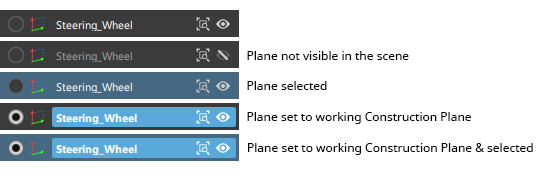

The name, look-at, and visibility area display with different highlights to indicate the state of the plane:

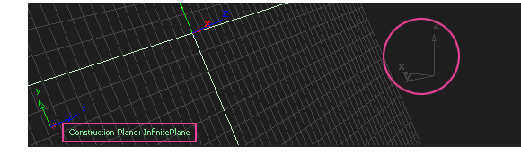

When working in a construction plane:
- The active construction plane is displayed at the grid axis gnomon in each viewport. The world axes stay visible but are displayed in the grid color.

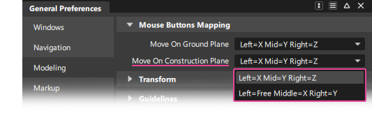

- Mouse behavior when using transform with a construction plane is specified in the General Preferences:

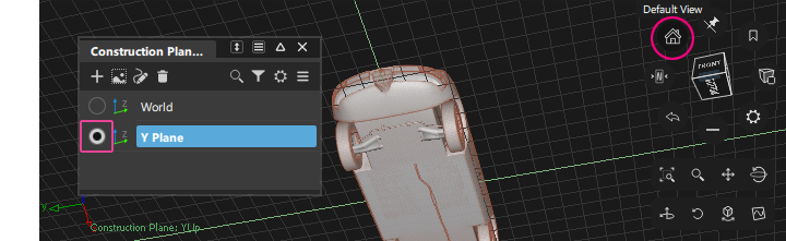

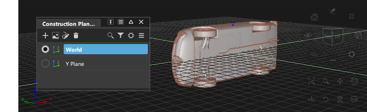

Working with the Y-up plane
Alias defaults to a Z-up grid orientation whereas as some (typically animation modelling) systems use a Y-up orientation.
The Y-up construction plane is useful when working with files imported from a Y-up system, in particular when you need to exchange data between systems without the need to rotate the actual geometry each time. Note that although the name of the construction plane is Y-up, the scene is shown as Z-up so that the x,y,and z directions are the same as for native Alias models.
- Import the file from the Y-up system - it will typically be positioned on it's side:

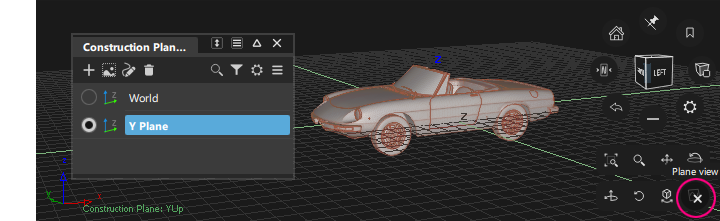

Select the Y-up plane in the Construction Plane Editor to make it the active working plane.
Use the Default View icon on the ViewCube to reorient the view.
- Use Plane View on the NavBar to match the viewing tools to the Y-up ground plane for easier view manipulation.
