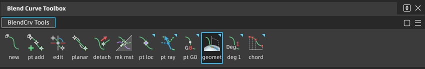

Changes how curvature is calculated at the picked blend curve constraint. Use either the Geometric Curvature or Parametric Curvature tools.
Access these tools from the Blend Curve Toolbox:
Geometric Curvature
