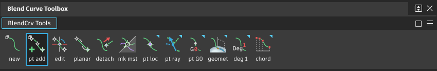

Access the Blend Curve Add Points tool from the Blend Curve Toolbox:
