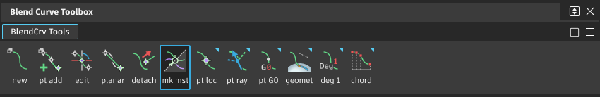

Blend Pt Make Master
Changes the relationship between the picked blend curve constraint and any constraints that it depends on.
Access this tool from the Blend Curves Toolbox palette:
