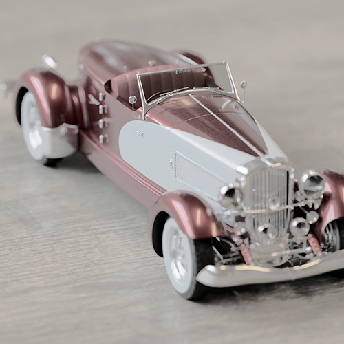

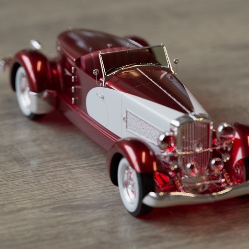

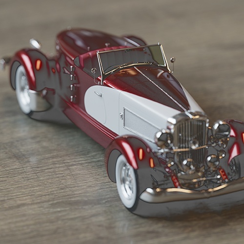

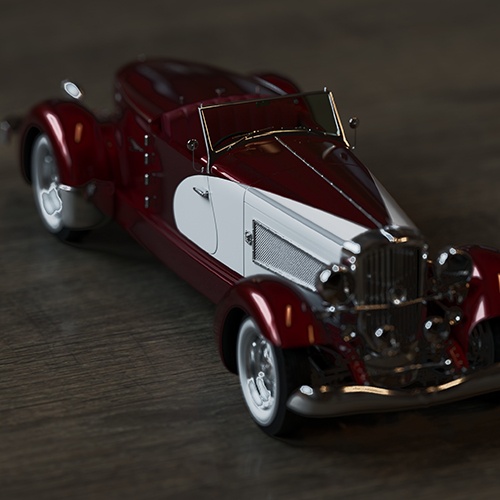

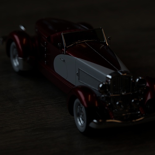

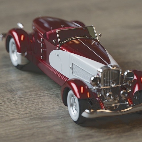

Main Saturation
Saturation multiplier for all values.
1 (default) | 0.5 | 0 |
Main Contrast
Contrast multiplier for all values.
1 (default) | 0.5 | 0.25 |
Main Gamma
Gamma amount for all values.
Main Gain
Gain color multiplier for all values.
Main Offset
Offset color amount for all values.
0 (default) | 0.5 | 1 |
Shadows Saturation
Saturation multiplier for darker values.
Shadows Contrast
Contrast multiplier for darker values.
Shadows Gamma
Gamma amount for darker values.
Shadows Gain
Gain color multiplier for darker values.
Shadows Offset
Offset color amount for darker values.
0 (default) | 0.25 | 0.5 |
Midtones Saturation
Saturation multiplier for midtone values.
Midtones Contrast
Contrast multiplier for midtone values.
Midtones Gamma
Gamma amount for midtone values.
Midtones Gain
Gain color multiplier for midtone values.
Midtones Offset
Offset color amount for midtone values.
Highlights Saturation
Saturation multiplier for brighter values.
Highlights Contrast
Contrast multiplier for brighter values.
Highlights Gamma
Gamma amount for brighter values.
1 | 0.5 | 0.25 |
Highlights Gain
Gain color multiplier for brighter values.
1 | 0.5 | 0.25 |
Highlights Offset
Offset color amount for brighter values.
0 (default) | 0.5 | 0.25 |
