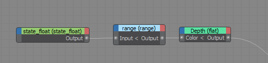

Depth Mask
  • Create a State Float shader. Set the Variable parameter to Ray Length (Rl).
  • Create a Range shader and connect the State Float shader Output to the Input of the Range shader. Change the following parameters of the Range shader:
    • Input Min: 0.6 (this value depends on the distance from the camera your object is).
    • Output Max: 1.5 (this value depends on the distance from the camera your object is).
    • Smoothstep: Enabled
Note:
Note that this mask directly depends on the distance from the camera.

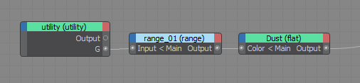

Object Position (n) Dust Mask
  • Create a Utility shader. Set the following parameters for the Utility shader:
    • Color Mode: Normal (n)
    • Shade Mode: flat
  • Create a Range shader and connect the Utility shaders Output.G to the Input of the Range shader. Enable Smoothstep and control the mask position with the Input Min/Max parameters.
If you cannot connect a single out color (Out G) to an Input in your DCC, use a RGBA to Float (mode G) shader to convert it.

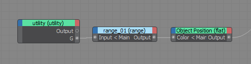

Object Position (P) Mask
    • Color Mode: Shading Point (P)
    • Shade Mode: Flat
