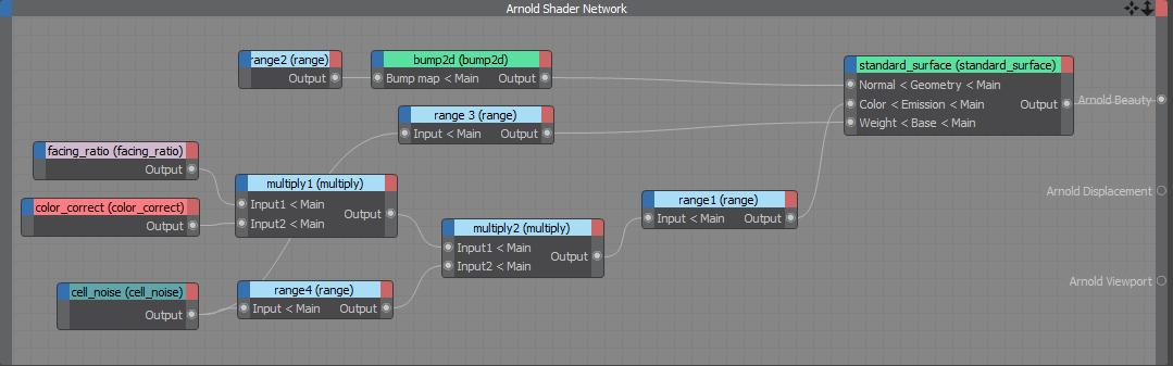

This simple tutorial demonstrates how to create an incandescent metal material. It uses a variety of shaders such as Facing Ratio, Range, Multiply and Cell Noise connected to the Emission Color of the Standard Surface shader. Thanks to Slava Sych for the assistance with this tutorial.

Range shader (range3)
Create a Range shader and connect it to the Base Weight of the Standard Surface shader. Connect the Cell Noise shader to the Input of Range3 . Change the following parameters:
  • Input Min: 0.249
  • Output Min: 0.3
  • Output Max: 0.7
  • Smoothstep: Enabled
Range shader (range2)
Create another Range shader and change the following parameters:
  • Input Min: 0.3
  • Input Max: 0.7
  • Output Min: 0.1
Bump2D
Create a Bump 2D shader and change the Bump Height to 0.02. Connect the Range shader (range2) to Bump Map in the Bump 2d shader, and connect the Bump 2d shader to Normal of the Standard Surface shader.
Facing Ratio
Create a Facing Ratio shader and change the following parameters:
  • Bias: 0.6
  • Gain: 0.48
  • Linear: Enabled
  • Invert: Enabled
Color Correct
  • Create a Color Correct shader. Change the input color RGBA to: 2.9642 0.5212 0 1
Connect the Facing Ratio shader and Color Correct shaders to a Multiply shader (multiply1).
Range Shader (range4)
  • Input Min: 0.249
  • Input Max: 0.484
  • Output Min: 0.7
  • Output Max: 1
  • Enable Smoothstep
Connect the Cell Noise shader (cell_noise1) to the Input of the Range shader (range4).
Create a Multiply shader (multiply2). Connect multiply1 to the Input 1 of multiply2.
Connect the Range shader (range4) to Input2 of multiply2.
Range shader (range 1)
Create a Range shader.
  • Change the Output Max to 3.
Connect the Multiply shader (multiply2) to the Input of Range shader (range1) . This is required for the higher value color intensity values.
Connect the Range shader (range1) to the Emission Color of the Standard Surface shader.
Now it is possible to control the incandescence using the Emission Weight (0 to 1). If you require more intensity, increase the Output Max value in Range shader (range1).
