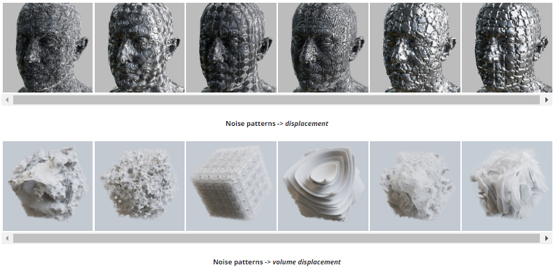

Noise shaders can be a powerful tool when used creatively. It is possible to create various effective patterns, for example, different types of corrosion, foam, landscapes, alien skin or just organic patterns. This tutorial demonstrates the types of patterns possible when setting different attributes with the Arnold Noise and Cell Noise shaders. Hopefully, this tutorial will inspire you to experiment and create your own patterns using a combination of Noise shaders. Thanks to Slava Sych for his assistance with this tutorial.

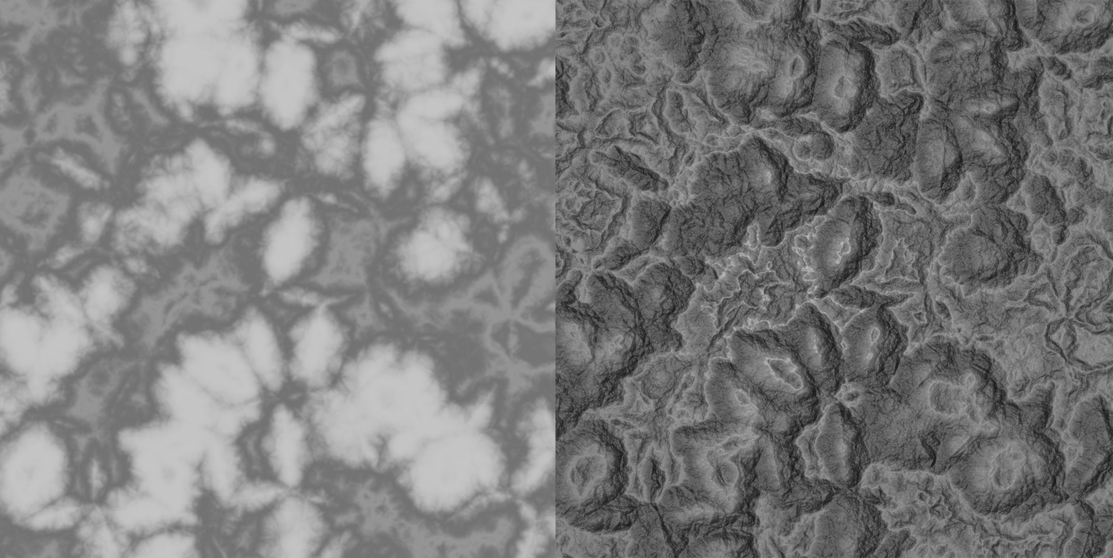

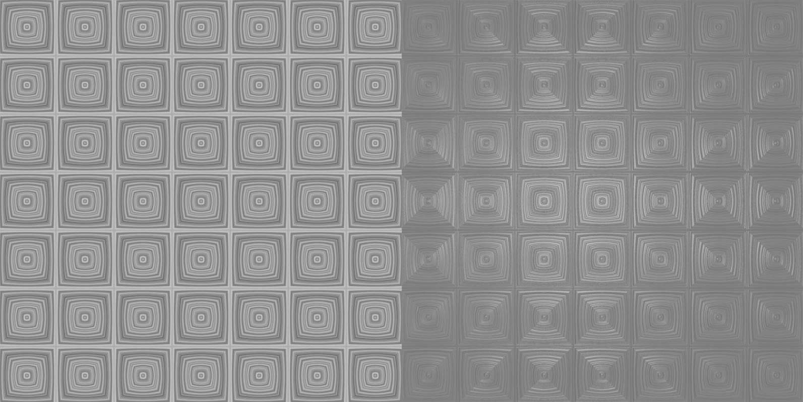

Noise Type 1
Octaves: 1. Distortion: 1.2. Lacunarity: 1. Scale XYZ: 10

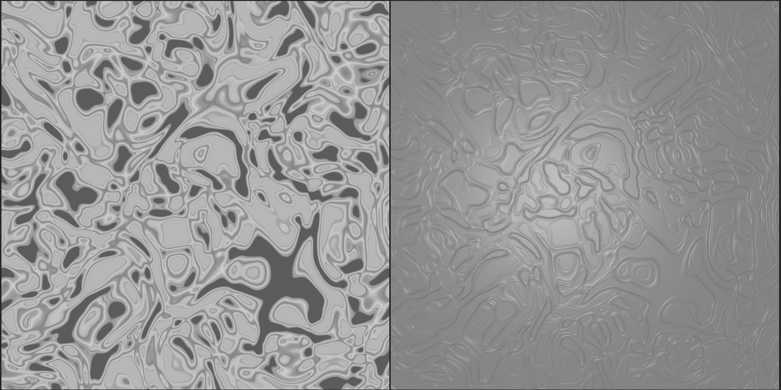

Noise Type 2
Octaves: 1. Distortion: 5.2. Lacunarity: 1. Scale XYZ: 10.

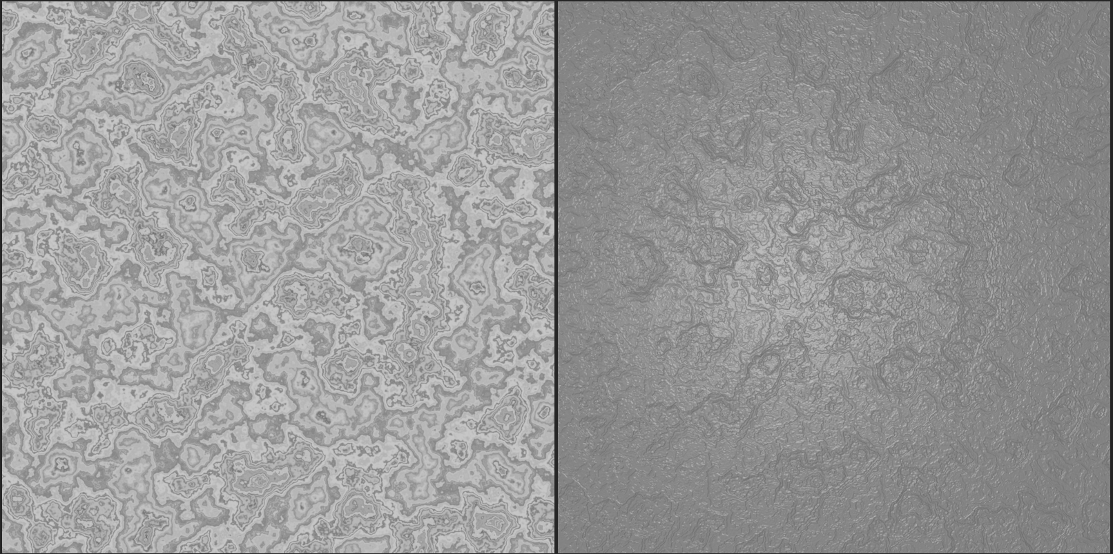

Noise Type 3 (Noise x2)
Create a noise shader and set the following parameters:
  • Octaves to 1.
  • Distortion to 5.
  • Lacunarity to 3.25.
  • Scale XYZ to 0.
Next, create another Noise shader and connect its output to the Offset parameter of the first Noise shader. Set the following:
  • Octaves to 5
  • Distortion to 4
  • Lacunarity to 1
  • Scale XYZ to 5

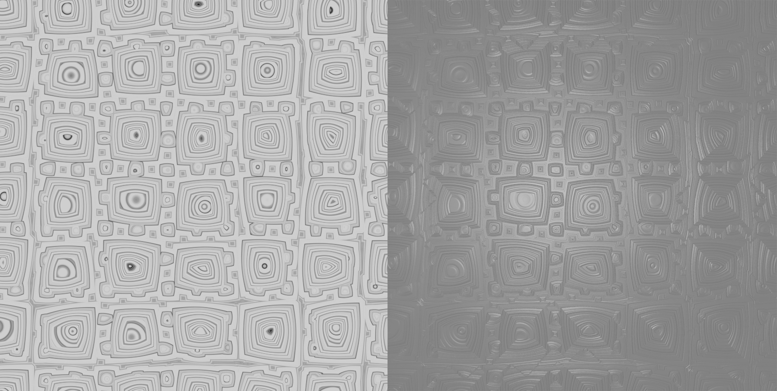

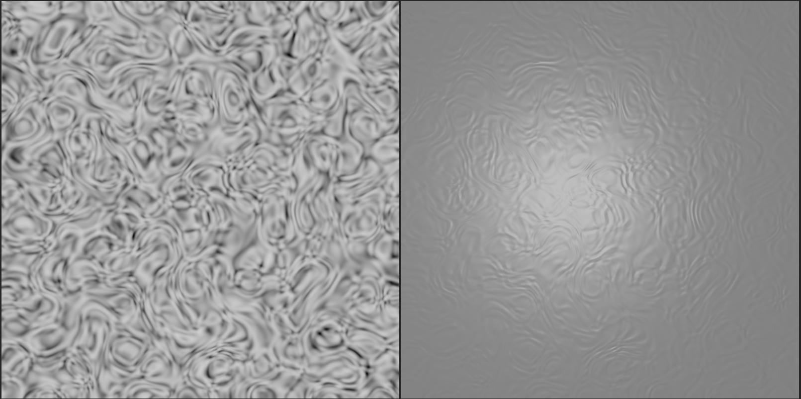

Noise Type 4 (Noise x2)
Create a Noise shader and set the following parameters:
  • Octaves to 1
  • Distortion to 5
  • Scale XYZ 10
Next, create another Noise shader and connect its Output to P parameter of the first Noise shader. Set the following:
  • Octaves to 2
  • Distortion to 3
  • Lacunarity to 1
  • Amplitude 0.21
  • Scale XYZ to 5

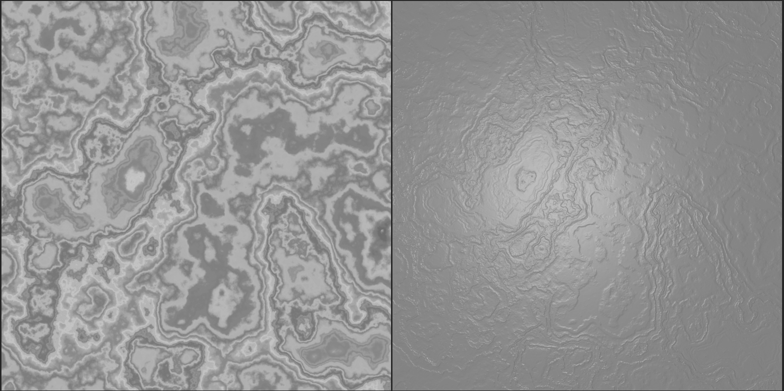

Noise Type 5 (Noise x2)
  • Octaves to 1
  • Distortion to 6.7
  • Lacunarity to 1
  • Scale XYZ 5
Next, create another Noise shader and connect its output to P parameter of the first Noise shader. Set the following:
  • Octaves to 4
  • Distortion to 0
  • Lacunarity to 2.68
  • Amplitude 0.719
  • Scale XYZ to 10

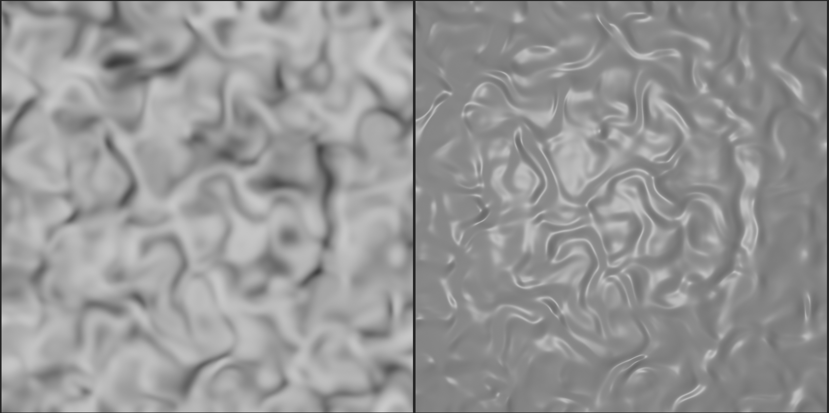

Noise Type 6 (Cell Noise ->Noise)
  • Octaves to 1
  • Distortion to 3.1
  • Lacunarity to 1
  • Scale XYZ 6
Next, create a cell_noise shader and connect its output to P parameter of the first noise shader. Set the following:
  • Octaves to 7
  • Lacunarity to 2.806
  • Scale XYZ to 7

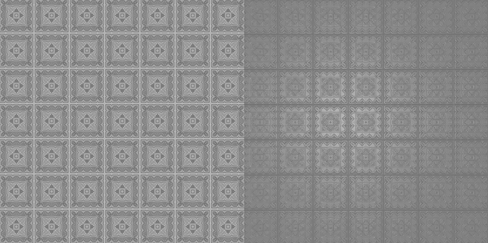

Noise Type 7 (Cell Noise ->Noise)
  • Octaves to 1
  • Distortion to 3.1
  • Lacunarity to 1
  • Scale XYZ 6
  • Disable additive
  • Octaves to 1
  • Lacunarity to 2.989
  • Scale XYZ to 7
  • Density to 0.286
  • Randomness to 0.583

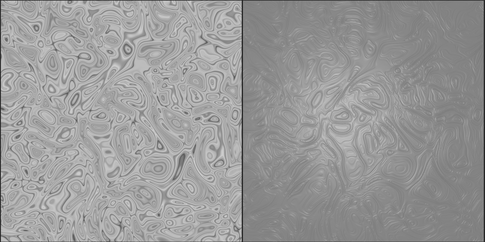

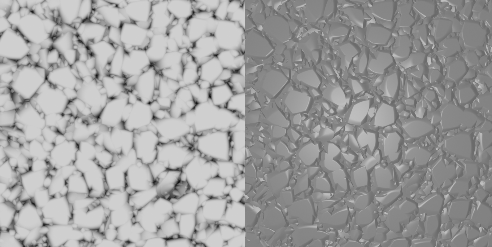

Noise Type 8 (Cell Noise ->Noise)
  • Octaves to 1
  • Distortion to 3.1
  • Lacunarity to 1
  • Scale XYZ 6
  • Change Pattern to worley2
  • Enable Additive
  • Octaves to 4
  • Lacunarity to 5
  • Amplitude to 0.114
  • Scale XYZ to 7
  • Density to 0.623
  • Randomness to 1

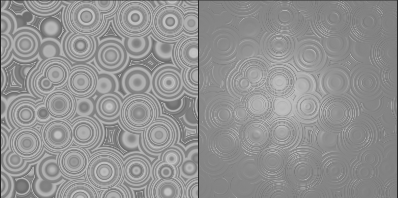

Noise Type 9 (Cell Noise ->Noise)
  • Octaves to 1
  • Distortion to 3.1
  • Lacunarity to 1
  • Scale XYZ 6
  • Change Pattern to alligator
  • Enable Additive
  • Octaves to 1
  • Lacunarity to 5
  • Amplitude to 0.920
  • Scale XYZ to 7
  • Density to 0.623
  • Randomness to 0

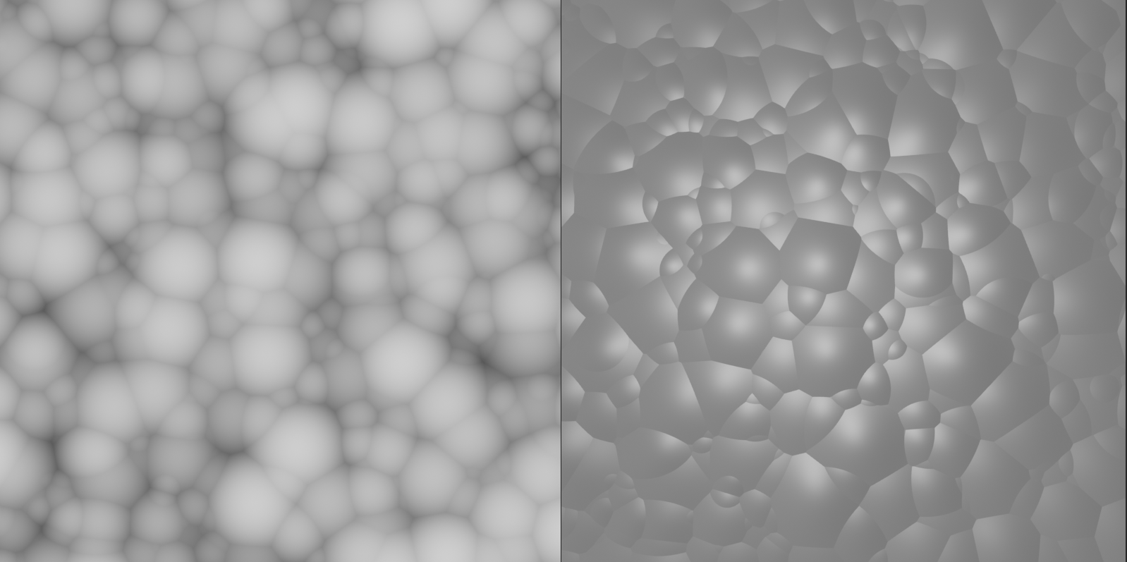

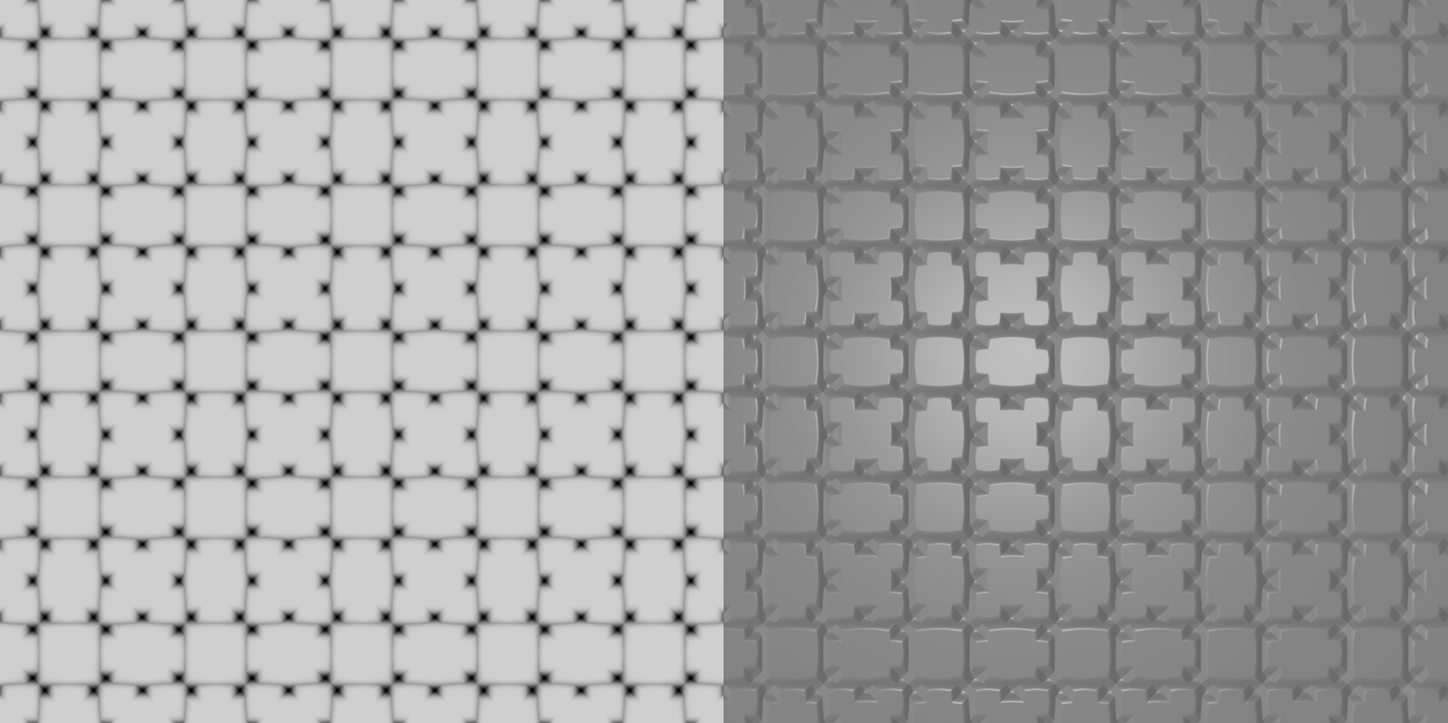

Cell Noise Type 1
Create a cell_noise shader and set the following parameters:
  • Disable Additive
  • Set Octaves to 4
  • Lacunarity to 1.274
  • Scale XYZ 10

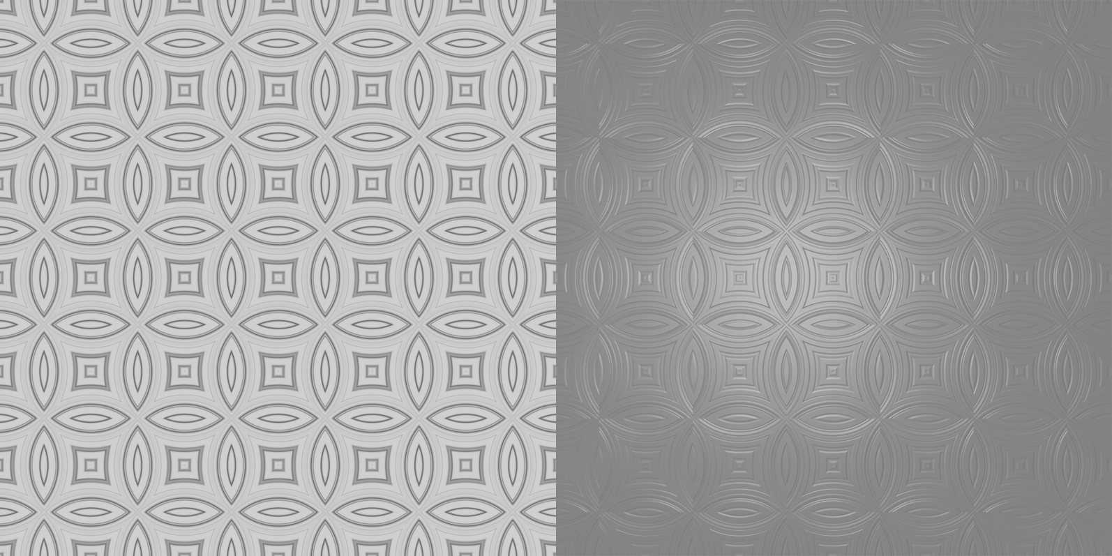

Cell Noise Type 2 (Cell Noise -> Range)
  • Disable Additive
  • Octaves to 2
  • Lacunarity to 1.5
  • Amplitude to 1
  • Scale XYZ to 10
  • Density to 0.326
  • Randomness to 0
Next, create a range shader and connect the cell_noise to its input parameter. Set the following:
  • Input_max to 0.343
  • Enable smoothstep

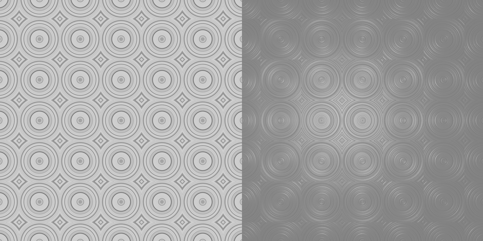

Cell Noise Type 3 (Cell Noise -> Range)
  • Disable Additive
  • Octaves to 6
  • Lacunarity to 1.297
  • Amplitude to 1
  • Scale XYZ to 10
  • Density to 0.326
  • Randomness to 1
  • Enable smoothstep

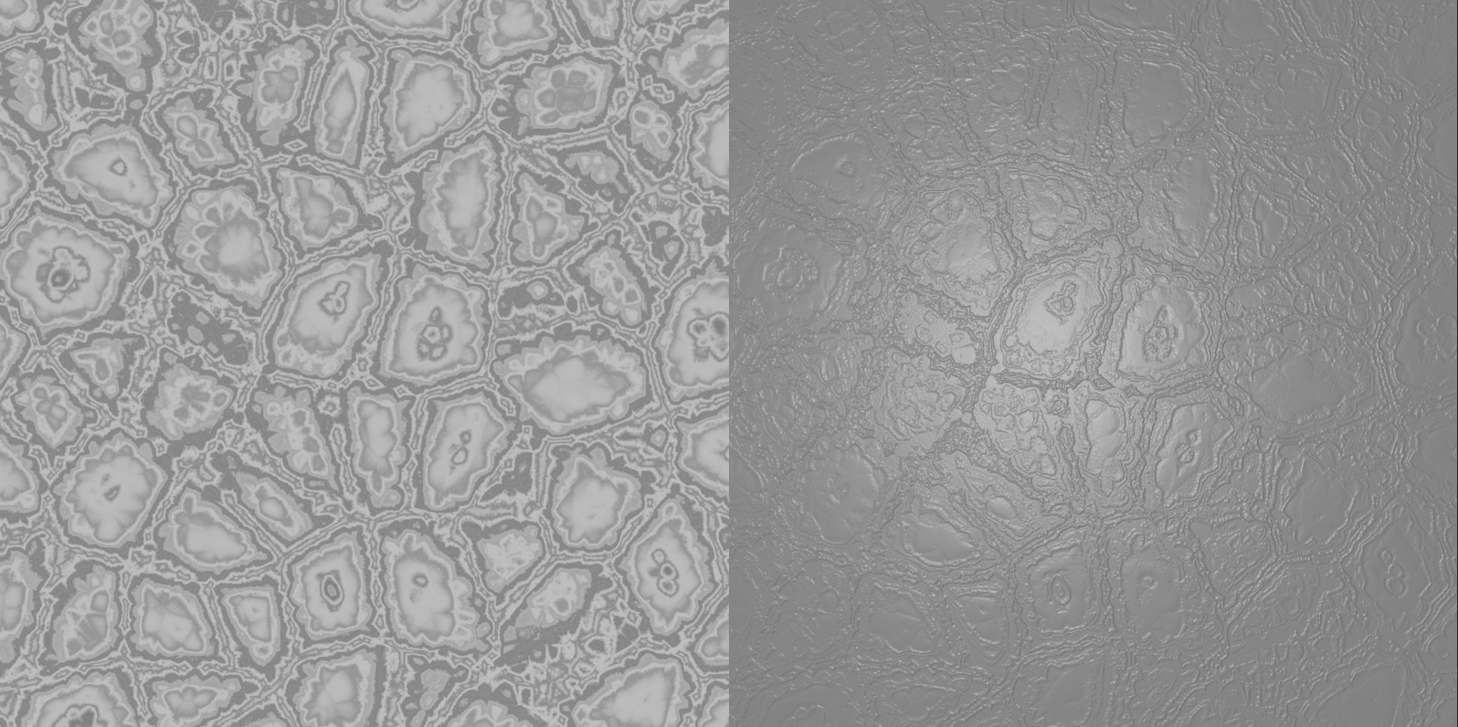

Cell Noise Type 4 (Cell Noise -> Cell Noise -> Range)
  • Enable Additive
  • Set Octaves to 3
  • Amplitude to 1
  • Scale XYZ to 10
  • Density to 0.326
  • Randomness to 1
Create another cell_noise and connect its output to P parameters of the first cell_noise. Set the following:
  • Enable Additive
  • Octaves to 3
  • Lacunarity to 1
  • Amplitude to 1
  • Scale XYZ to 6
  • Density to 0.5
  • Randomness to 0
Next, create a Range shader and connect the Cell Noise to its input parameter. Set the following:
  • Input Max to 0.343
  • Enable smoothstep
Or set parameters in the second cell_noise to get a result like in the image below:
  • Change Pattern to worley1
  • Disable Additive
  • Octaves to 3
  • Lacunarity to 1
  • Amplitude to 1
  • Scale XYZ to 6
  • Density to 0.5
  • Randomness to 0
Or s et parameters in the second cell_noise to get a result like in the image below:
  • Disable Additive
  • Octaves to 2
  • Lacunarity to 2.189
  • Amplitude to 1
  • Scale XYZ to 6
  • Density to 0.5
  • Randomness to 0.183
