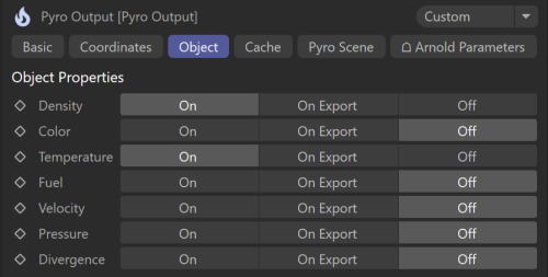

To be able to render the volume in the IPR, you must set the channel to On state in the Pyro Object.

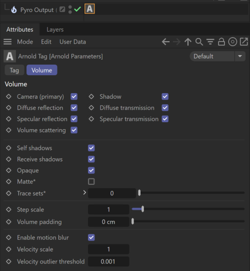

Arnold-specific settings can be edited via an Arnold tag assigned to the Pyro object.
See Common Shape Parameters for more information on generic shape parameters.
Step Scale
A scaling factor applied to the step size to modulate the automatic value. For low-frequency, smoke-like volumes, a value of 4 is a reasonable starting point.
Info: More information about volume Step Size can be found here.
Volume Padding
Further Reading
See the Arnold User Guide.

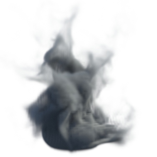

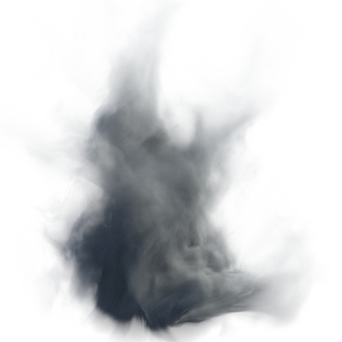

Enable Motion Blur
When enabled, motion blur is calculated from the velocity channel of the volume.
Note:

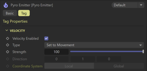

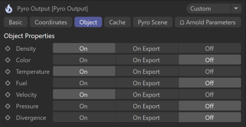

Velocity channel must be enabled in the Pyro Emitter and Pyro Object.
Note:
Motion blur must be enabled in the render settings.
Velocity Scale
A scale factor for the velocity field. A value of 0 disables motion blur.
Velocity Threshold
Controls filtering of noisy velocities resulting in the faster rendering of motion blur from physics simulations. The default value of 0.001 should have little to no visual impact. Setting it to zero disables filtering entirely.
