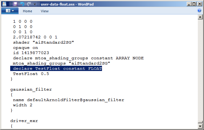

It is possible to create arbitrary user data that can be attached to any object. This user data can then later be used at shading time by specific nodes with a user prefix. The convention used to store the user data can be found in different data types, such as color and float. For example:
  • Create an aiUserDataFloat and call it TestFloat:
  • Export the scene as a .ass file and open it in a text editor. We can see that the float TestFloat is stored in the .ass file as follows:
