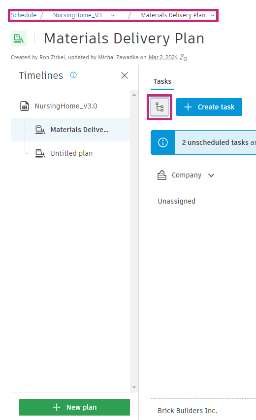

You can navigate connected plans using breadcrumbs or contextual navigation panel.

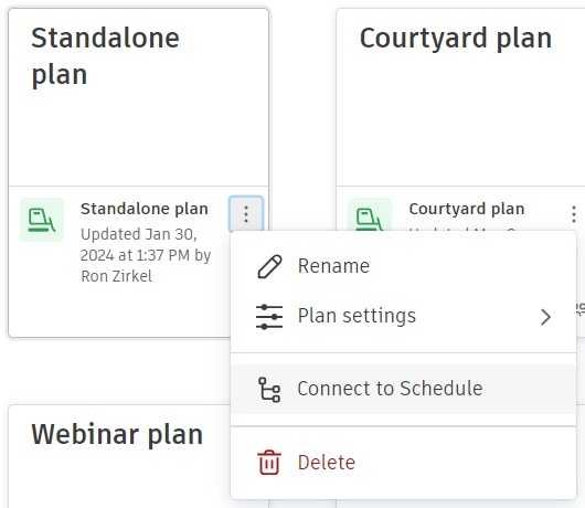

Connect Plan to Schedule
To connect a standalone plan to a schedule:
- Open the Schedule tool homepage or a standalone plan.
- Click Connect to Schedule.
- Select the schedule you want to connect the plan to.
- Click Connect.

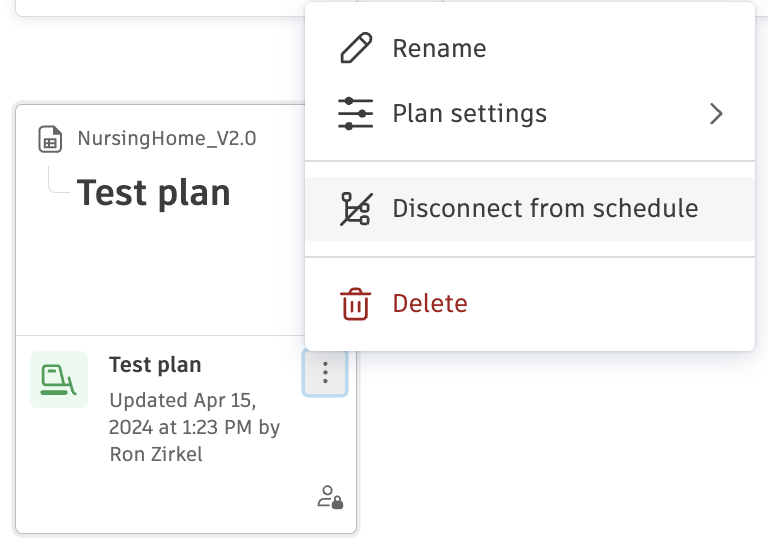

Disconnect Plan from Schedule
Plan managers can disconnect plans from schedules from the Schedule tool homepage using:
- Plan thumbnail
- Plan row (on 3 dots menu)
When a plan is disconnected, it becomes a standalone plan. The disconnected plan will retain its structure and permissions, but some changes will occur:
- Connected task icons will be removed
- Tasks with subtasks will maintain their hierarchy and behavior
- The Compare to schedule option will be disabled in the plan configuration panel
- Plan permissions will remain unchanged
- The schedule members reference group will switch to project members
In the schedule view, activities that lose their connection to disconnected tasks will no longer display those tasks in the connected activity tooltip. If an activity no longer has any connected tasks, the connected activity icon will be removed.
After connecting a standalone plan to a schedule, it is possible to disconnect it if needed. However, connecting a plan to a schedule may result in changes to the plan's permissions.

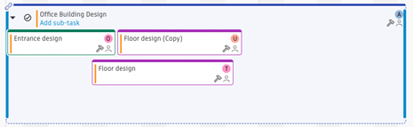

Twinned Tasks as Summary Tasks
Tasks connected to scheduled activities can have multiple subtasks.
All standard actions can be done on these subtasks, like creating, moving, adding handoffs, etc.

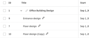

Subtasks under a twinned summary task appear:
In the task list, indented under their parent twinned summary task
In the swimlane view, grouped together under their twinned parent summary task

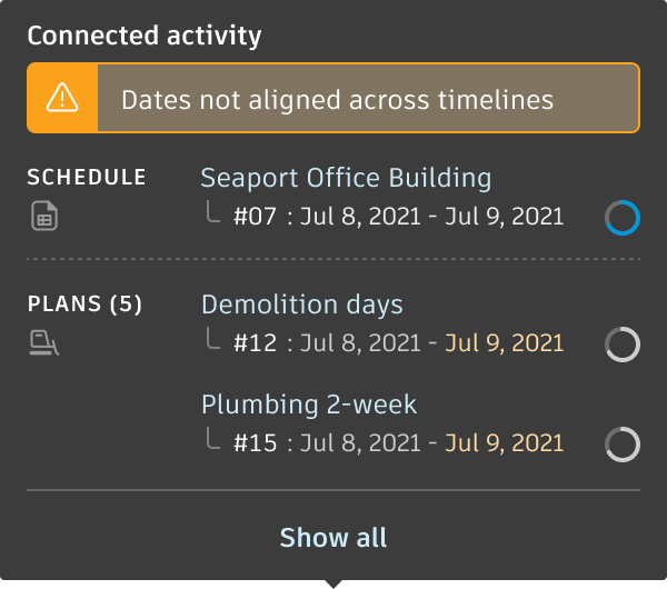

Date Misalignment
Dates in the plan can become misaligned with the schedule. This misalignment is usually a result of:
- A change in the task date within the plan.
- A change in the activity date when the schedule is updated with a new version.
- A difference in non-working days in the imported schedule and the plan.
- A removal of the schedule's activity with a connected plan
Date misalignments are indicated when a connected task has dates that differ from the linked schedule activity. The indications will appear as an alert in both the plan and in the schedule and also in the swimlane view as a misalignment of the range.
By hovering or clicking your cursor over the misalignment alert icon
, you can see:
- Schedule name
- Activity dates
- All connected plans
- All connected task dates that are marked as misaligned
