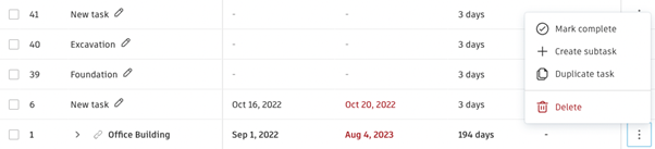

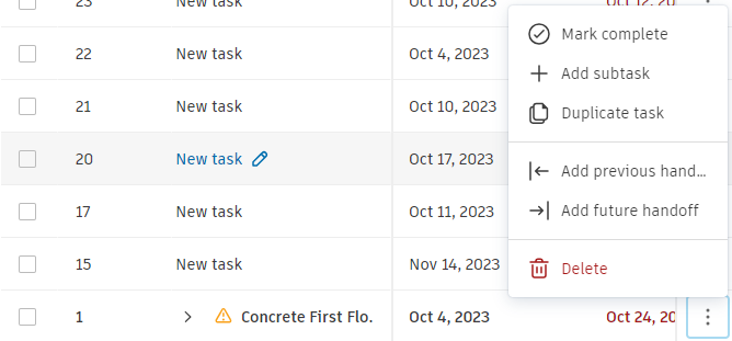

To create a subtask in the List view:
  1. Click the quick action menu on the right of the parent task.
  2. Select Add Subtask.

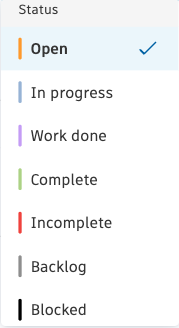

Status Open, Backlog, In progress, Blocked, Complete, Incomplete Open

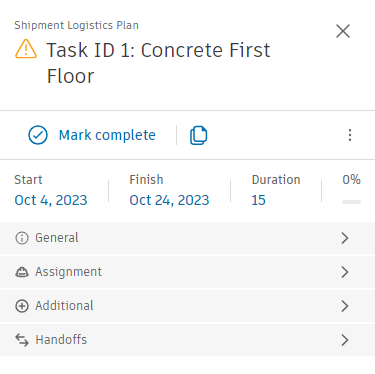

Task Detail Panel
To open the task panel and view/edit details:
Double-click on the task in the Swimlane view or click the task title or ID in the List view.
Section Field/Option Description
Dates & Progress
  • Start/End Dates - Edit the date range. Dates will be adjusted based on task handoffs and restrictions. The red color indicates overdue dates.
  • Duration - View and edit the task duration.
  • % Complete - Indicate what percentage of the task is complete.
General
  • Type - Choose Task or Milestone
  • Work Type
  • Title - Edit the task title
  • Description - Add text to summarize or give information about the task. Supports rich text formatting like bold, italics, checklists, etc.
  • Status - Select the task status. Each status has an associated color indicator.
Assignments
  • Company - Assign the task to a company.
  • Assignee - Assign the task to a person.
  • Role - Assign the task to a role.
  • WBS - Assign the task to a Work Breakdown Structure category.
  • Location - Assign the task to a location.
Additional
  • Priority - Set the priority - Low, Normal, High
  • Crew Size - Specify the number of people needed for the task.
Handoffs
  • Previous Handoffs - Tasks that preceded the current task.
  • Future Handoffs - Tasks that depend on current task.

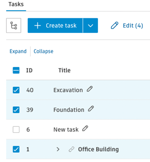

Multiple Task Editing
You can select multiple tasks and batch edit their attributes all at once, such as changing the status or assignee for multiple tasks together.

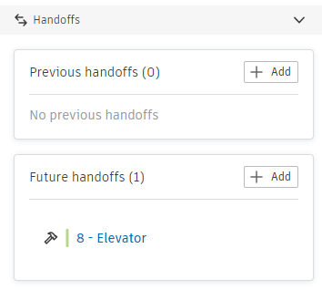

Task Handoffs
Linking Dependent Tasks
You can link tasks to show handoffs and enable cascading date changes.

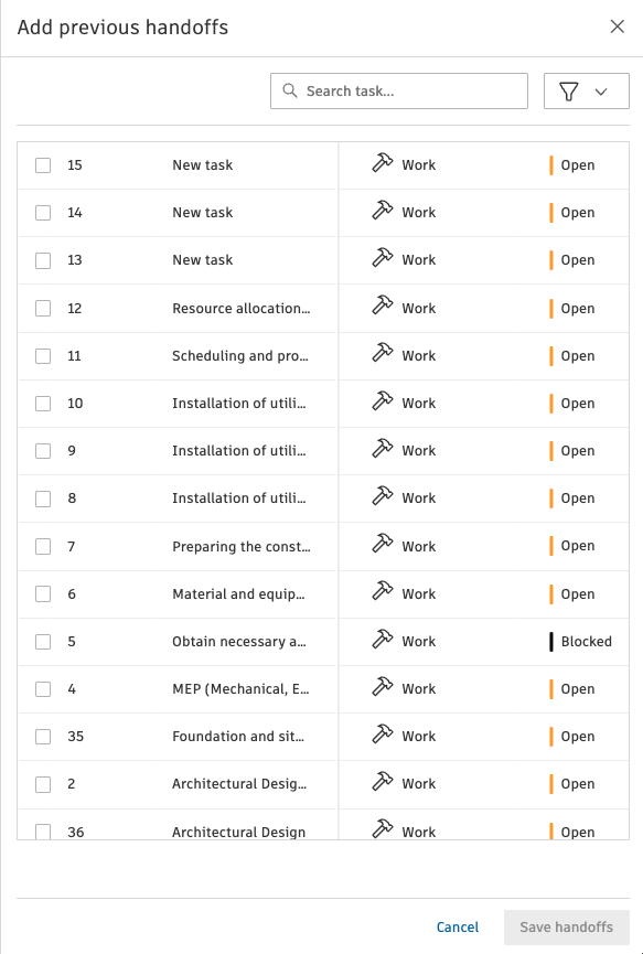

Adding Handoffs
You can add handoffs in two ways:
In the Task Panel:
  1. Click Add.
  2. Select previous and/or future handoffs.
  3. Multi-select from the task list.
  4. Filter by time and work type.
  5. Search by title.

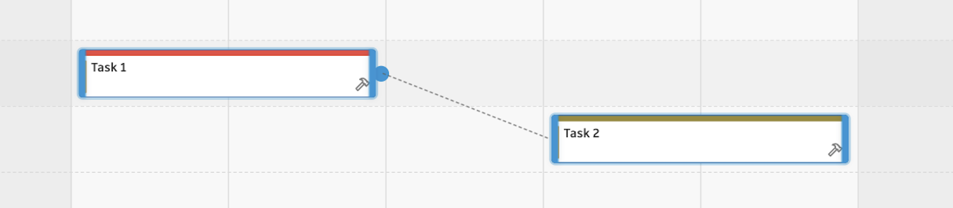

In the Swimlane View:
  1. Drag-and-drop handoff holds on the sides of a task card.
  2. Connect to the desired parent/child tasks.
Removing Handoffs
To remove a handoff in the Swimlane view:
  1. Right-click the link indicator between two tasks.
  2. Select Remove Handoffs.

Actions
There are various operations that can be performed quickly on tasks such as:
  • Delete - Permanently remove and delete selected tasks.
  • Quick Complete - Mark selected tasks as complete with a single click.
  • Duplicate - Make copies of selected tasks within the plan. Tasks can be duplicated with or without subtasks.
  • Detach - Convert a subtask into a standalone task, removing it from under its parent task.
  • Reopen Tasks - Tasks marked as complete or incomplete can be reopened, changing them back to an open status.
  • Move - Relocate tasks to a different row or group based on the Group by configuration. This can be done by dragging tasks on the swimlane canvas.
  • Attach - Convert a standalone task into a subtask under a chosen parent task. This can be done by dragging the task onto a parent task card on the swimlane canvas.
Note: Dragging and dropping task on expanded summary task will add it as subtask. Dragging and dropping task on collapsed summary task will add it as connected task.
Actions can be performed in the following ways:
  1. Bulk actions: Select a number of tasks from a swimlane or list and click on the actions menu.

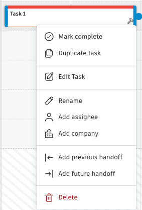

  2. Right-click edit: Right-clicking on a task card in the swimlane.
  1. Quick menu of selected tasks in the list.
  1. Through the task details panel.

    • Right-click on the task in the swimlane view and select Commit

  • Certain right-click actions are removed (Rename, Add assignee, Add company)
When editing affects handoffs:
  • If changing a task impacts a committed task later in the sequence, the handoff breaks automatically before the committed task

The Incomplete status indicates a task commitment was broken because the task could not be completed as planned.
To mark a committed task as Incomplete:
  1. Open the task detail panel.
  2. Change the status to Incomplete.
  3. Select a Root Cause explaining why the task is incomplete.
  4. Click Save.

Bulk Editing Committed Tasks
When bulk editing tasks that include committed tasks:
  • Fields requiring root causes are disabled for committed tasks
  • The Incomplete status option is disabled if any selected task is committed
  • Fields are disabled if editing is restricted due to commitments, permissions, or other reasons
