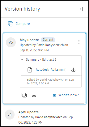

Version history pane
The Version history pane allows you to select the schedule's version to view or compare different versions of the schedule.
You can Edit the version's name, Summary or download the attached files at any moment.
