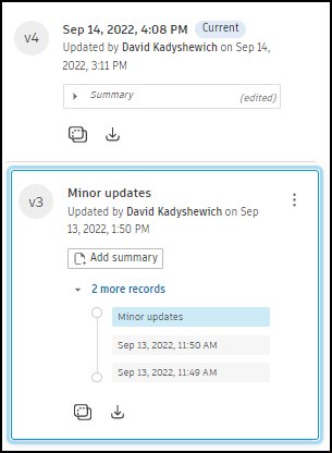

- In the authoring tool, update the schedule and save changes. Saved changes are reflected as a new schedule version in the Files tool. This updated version is shown in the Schedule tool.
When using Desktop Connector for Autodesk Docs or updating the schedule from Docs small edits are grouped as records under a single version to avoid clutter in the Version history pane.
A new version is cut off:
- every day (intraday changes are grouped)
- when a version is edited or distributed in the Schedule tool
- when a new schedule file is manually uploaded
