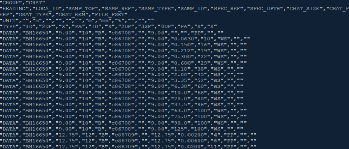

The AGS format is an industry format created and supported by organizations in the subsurface and site investigation industry. This standardized format provides workflows to transfer subsurface investigation, laboratory testing, and monitoring data between a diverse array of software used in the industry. To learn more about the AGS format visit: ags.org.uk.

- Next select the Import Borehole Data From File button near the top of the dialog box.
- Select the AGS data file to connect to the project database. A dialog box will alert you that the “borehole data was imported successfully”.
