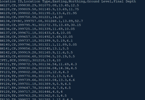

Location Details.csv
This CSV file provides the tool with information about each borehole sample location. The data includes location identifier, location type, coordinates and elevation, and the final depth of the sample. The file name must match the section title above exactly with data headers matching below:
Header Description Example
Location ID* Sample location identifier BH143
Location Type* Sample method or testing activity CP
Easting* Easting or longitude of sample 764903.03
Northing* Northing or latitude of sample 2951457.60
Ground Level Elevation relative to sampling / project datum 9
Final Depth Depth of sample 11.4
  • Indicates a required field
See the provided screenshot for an example Location Details CSV file: EXAMPLE OF THE LOCATION DETAILS.CSV DATA FORMAT

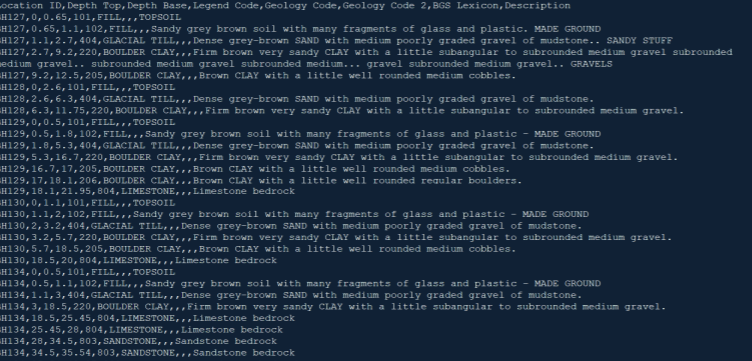

Field Geological Descriptions.csv
This CSV file contains all of the strata information for each of the samples. There are four categories for storing the stratum data including: Legend Code, Geology Code, Geology Code2, and BGS Lexicon. These files are not all required, but at least one should be populated. The Geotechnical Modeler tool permits you to select any of these data categories for visualization or constructing the strata surfaces. The file name must match the section title above exactly with data headers matching below:
Depth Top* Depth to the top of the stratum 0.65
Depth Base* Depth to the bottom of the stratum 2.10
Legend Code Data field (Legend Code in Civil 3D) 404
Geology Code Data field (Geology Code in Civil 3D) GLACIAL TILL
Geology Code2 Data field (Geology Code2 in Civil 3D) SAND
BGS Lexicon Data field (BSG Lexicon in Civil 3D) 227
Description General characterization of stratum Dense grey-brown
SAND with medium
poorly graded gravel
of mudstone.
See the provided screenshot for an example Field Geological Descriptions CSV file: EXAMPLE OF THE FIELD GEOLOGIC DESCRIPTIONS.CSV DATA FORMAT
