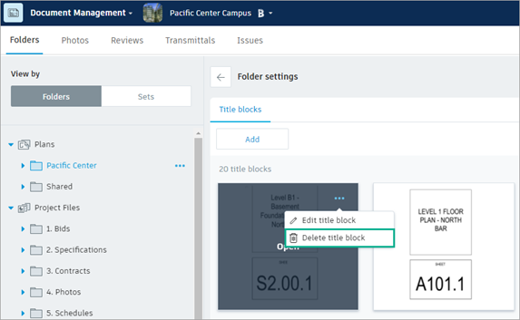

Delete Title Blocks
  1. In Document Management, click the Folders tab.
  2. In the folder tree, select a folder.
  3. Click Title Blocks next to the selected folder.
  4. Hover over the top right corner of the title block you want to delete, and then click Delete Title Block.
  5. When prompted to confirm your choice, click Delete.
