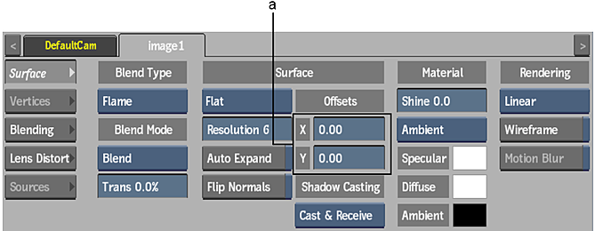

  1. Select the surface you want to offset.
  2. In the Surface menu, change the Surface Offset X and Surface Offset Y fields accordingly.
    (a) Surface Offset fields

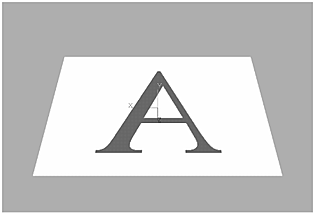

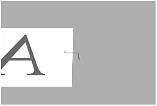

The following figure illustrates the difference between rotating a surface that has not been offset and a surface offset using the Surface Offset X field.
Rotated image with no offset. Notice that the axis is in the centre of the image. Rotated image with an offset along the X-axis. Notice that the axis is offset from the image centre.
