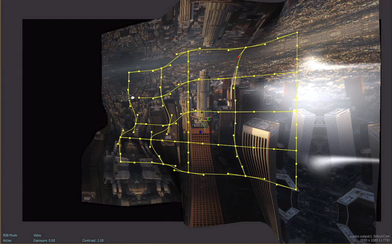

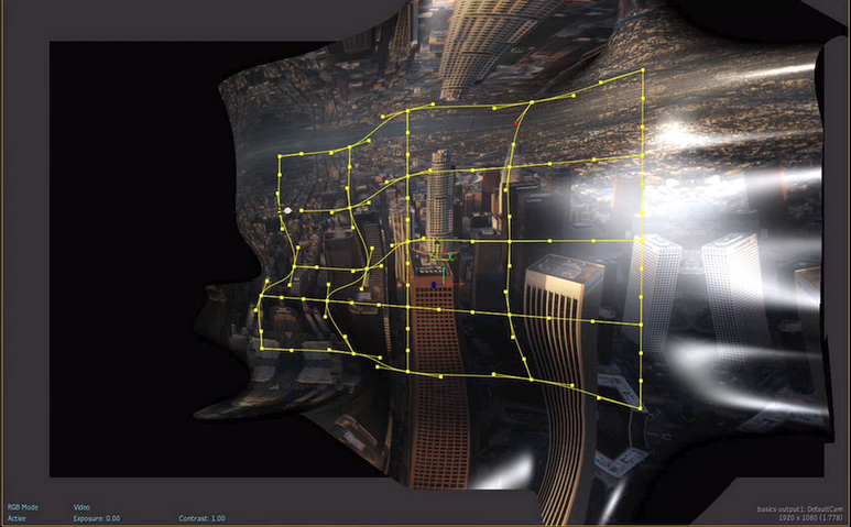

Using the extrapolation sliders, you can extrapolate the texture beyond the geometry, in X and Y. You can assign negative extrapolation values and effectively crop the texture. The extrapolation is in mirror mode, by default. You can change this by adding a Diffuse node in the Action schematic. When working with an Extended Bicubic surface, you can choose between Linear Extrapolation and Smooth Extrapolation. Smooth extrapolation produces a more organic deformation, extrapolating the deformation created by the vertices and tangents, while Linear extrapolates the surface in a straight line after the last vertices, in the direction of the tangents.
Linear extrapolation

Available for extended bicubic surfaces only, and when the size offset fields are not at 0. Select Linear to extrapolate the Surface in a straight direction. Select Smooth to extrapolate smoothly based on the position of the vertices of the surfaces.
