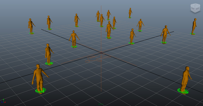

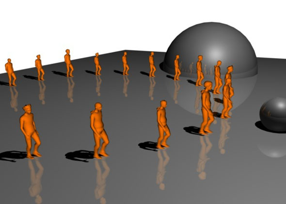

Why are my characters (or parts of them) orange?
When a shader is not found in the scene (see below to understand how Golaem look for them), Golaem applies its default orange shader.
You need to import the corresponding shaders in the scene (or make
visible the meshes they are applied to).

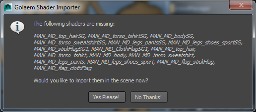

How to import shaders in my rendering scene?
If you did not import shaders for your characters when creating your EntityType, you can still import them afterwards.
Use the Import Shaders button
. Golaem
will analyze the scene and based on the Character File used, will
display which shaders are missing and propose to import them. Click Yes
Please!
Browse to the shaders file corresponding to your renderer (e.g. /golaem/shaders/CMO-man_golaemLight_AR.ma for Arnold).
The Shader Importer Tool imports this file in the scene and strips it from its namespaces to make the shaders' names to match with their name in the Character File.

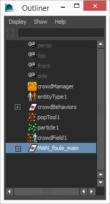

Do not hide the source model which has been imported at the center of your scene. It needs to be active for the linked shaders to be found by your renderer. You can move it outside the camera view, or change the render stats on its meshes (in the Golaem Character Pack, primary visibility & co are already set to off ), but it must not be hidden.

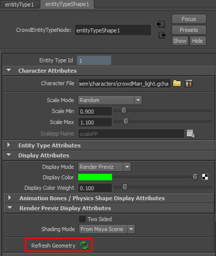

After loading the shaders, if you already played your simulation once, they may still not be refreshed and you may still see oranges characters.
In this case, select the Entity Type and go to the Display Attributes, open the Render Previz Panel and hit the Refresh icon, then rewind and hit play to get see your characters correctly displayed.

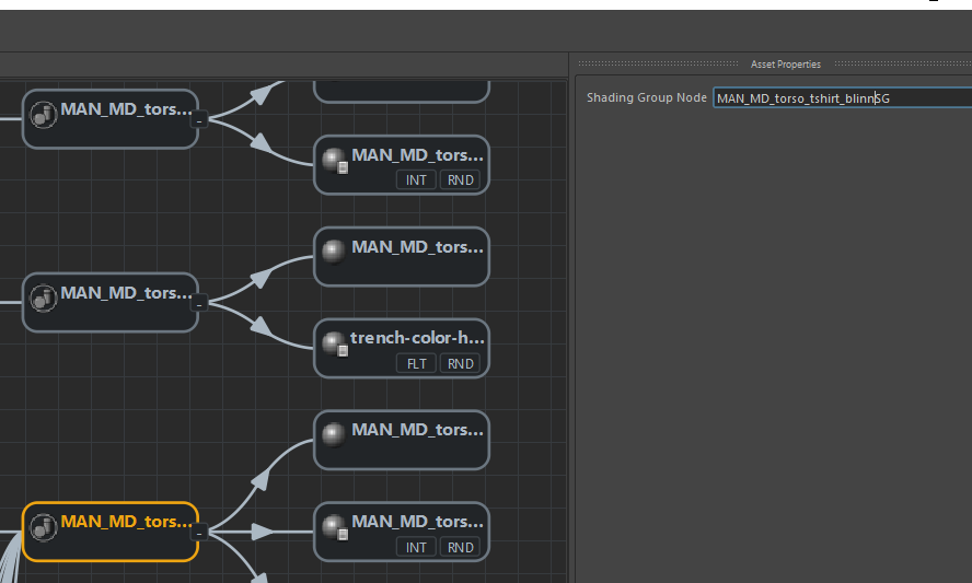

As explained here, shading assignment is simply done by attaching a Shading Group / Shader name to a Mesh name in the Character File (.gcha). If you'd like to change the Shader assigned to a Mesh, you just have to rename it in the Character File (right click / Rename):

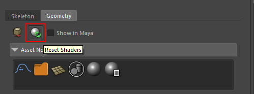

If a massive change of Shading assignment as been made on a Maya Character, you can also import it in clean Maya Scene, open your Character File with the Character Maker, select the highest node in the tree list you'd like to update and use the Reset Shaders tool. It will look at the list of meshes listed in the Character File selection, find geometry nodes with the exact same names in Maya and refresh the names of the Shading Groups / Shaders in the Character File based on the Maya scene.
That's it! The Character Geometry File (.fbx) don't need to be updated as it's not involved at all in the Shading Process.

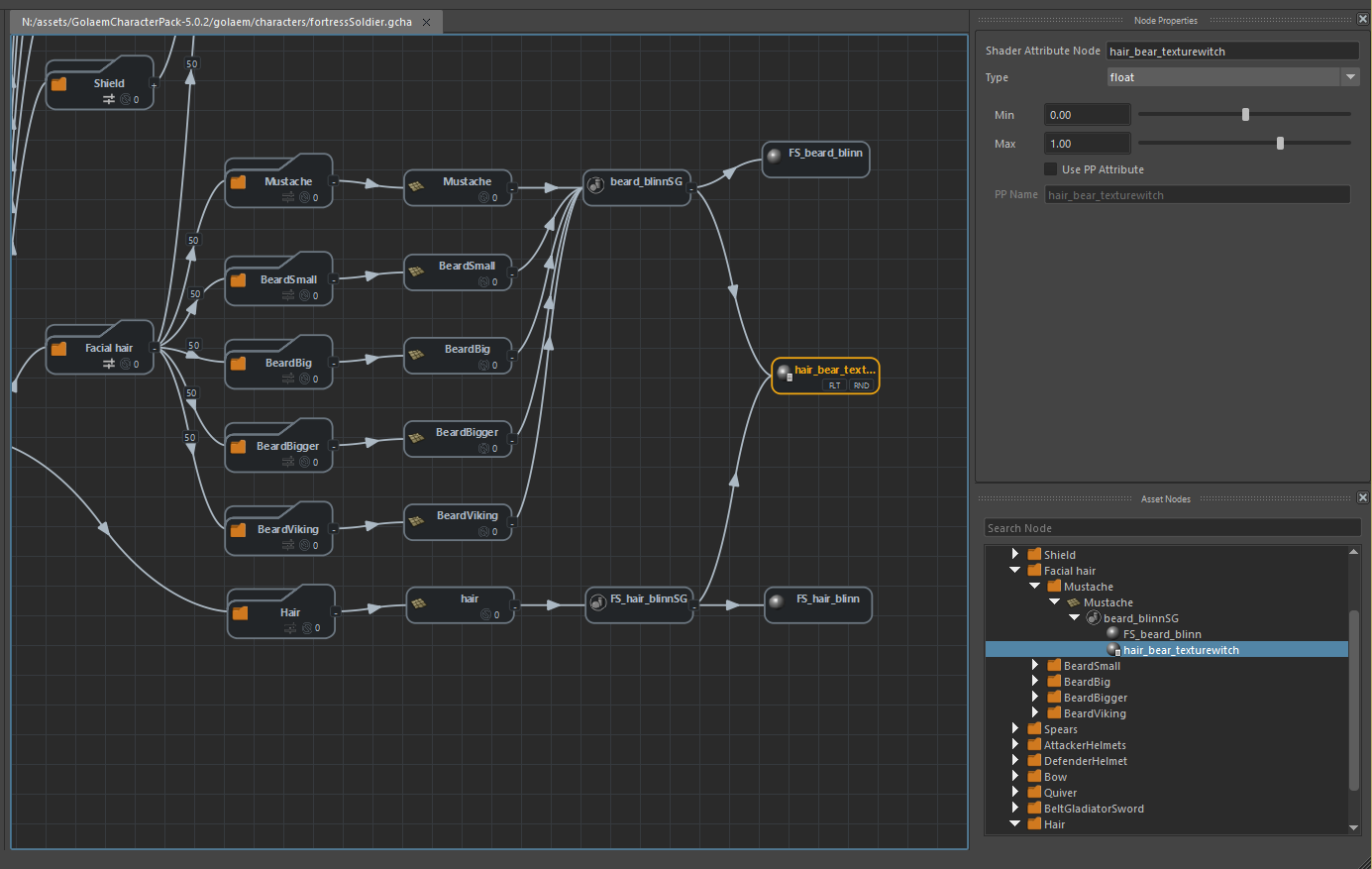

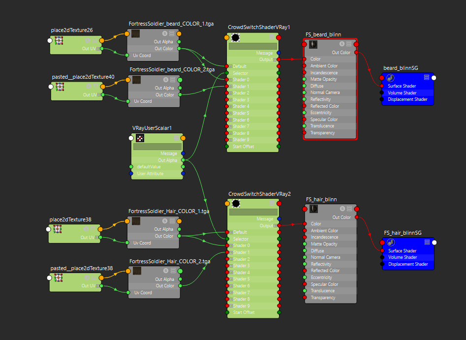

How to assign the same Shader Attribue to multiple meshes?
Maybe you would like to assign the same texture or hue to multiple shader and thus to multiple meshes (e.g. beards/hair...). To do so just link the Shader Attribute node (e.g Vray user scalar when rendering with Vray) to the desired shaders nodes.
And remap the shader nodes accordingly in the Character Maker Geometry tab.
Don't forget to save you gcha and Character Shader scene.
