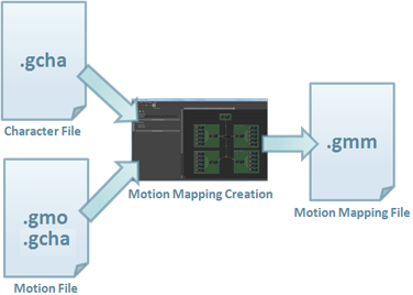

Motion Mapping File Workflow

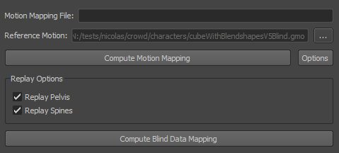

Before loading or editing a Motion Mapping, you must first load a Reference Motion (or Motion Skeleton Mapping) file. This is needed in order to display the correct Limb and Effector nodes when mapping a Channel in the Main Workspace. The reference Motion file can be changed at any moment, but keep in mind that if names are different the Motion Mapping for the new reference Motion can be incorrect.
Computing A Motion Mapping
You can access this feature through:
  • Side panel: Compute Motion Mapping... button
This command maps the current Skeleton Mapping to a Motion loaded from a .gmo fie. It prompts to load a Motion file. The computed Motion Mapping is displayed in the Main Workspace where it can also be edited if needed. Automatic Motion Mapping is done based on the location of a Channel (the location of its Limb).

Replay Pelvis When enabled, the Motion will be played on the bone mapped to the Pelvis, otherwise this bone will be static and the whole character won't replay the global position/orientation.
Replay Spines When enabled, the Motion will be played on the bones mapped to the Spine nodes, otherwise these bones will be static.

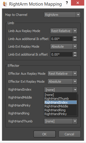

Other replay options are editable by directly right-cliking on the channel, and on Edit Motion Mapping after that:
Motion Mapping Dialog
Map to Channel
Name of the Channel to which the Motion will be mapped. [none] if not mapped.
Limb Aux Replay Mode See the Replay Mode page
Limb Aux additional Ik Offset See section Replay Mode of the Character Main Concepts.
Limb Ext Replay Mode See the Replay Mode page
Limb Ext additional Ik offset
Effector Aux Replay Mode See the Replay Mode page
Effector Ext Replay Mode See the Replay Mode page
Effector Mapping

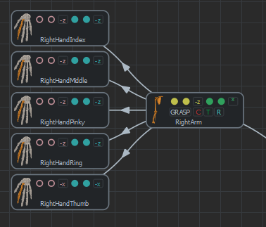

Name of the Effector to which the Motion will be mapped, for each Effector in the selected Channel. [none] if not mapped. Effector mapping is only available when the Channel is set, i.e. Map to Channel is not empty ([none]).
Effector names are displayed on the Effector nodes, and their tooltip, as shown on the image below.

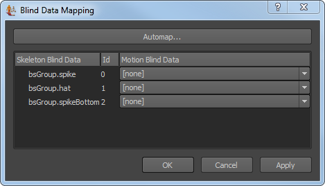

Blind Data Mapping
To edit the Blind Data Mapping, click on the Blind Data Mapping... button. This opens the Blind Data Mapping Dialog (see figure below).

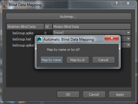

The Blind Data Mapping Dialog lets you map Blind Data and Blend Shapes between the character and the reference motion.
The mapping can be computed automatically by clicking on the Automap... button. Two modes are available:
  • Map by name: mapping is done by matching the names of the Blind Data and Blend Shapes
  • Map by id: mapping is done by matching the ids of the Blind Data and Blend Shape
Automatic Blind Data Mapping
Once the Blind Data mapping is done, click on the Apply button and close the dialog, or click on the OK button.

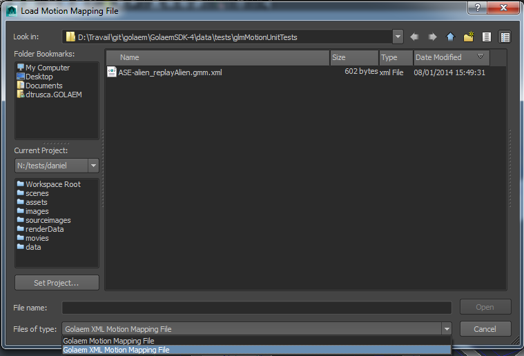

The Character Maker can also load and save Golaem XML Motion Mapping Files (*.gmm.xml). These files cannot be directly used in a crowd simulation and are mainly intended for advanced users and debugging purposes. An XML Motion Mapping File can be edited in a text editor, reloaded into the Character Maker, and saved back to a binary Motion Mapping File that is usable in a crowd simulation.
To load or save an XML Motion Mapping File, select the Golaem XML Motion Mapping File type at the bottom of the load or save Motion Mapping File dialog (see below).
Loading a Golaem XML Motion Mapping File
