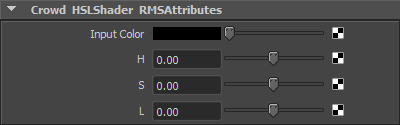

Configuration
| Input Color | Input shader/textures slot to modify |
| H, S, L | Hue, saturation, lightness parameters (between -1. and 1.). 0 means that the parameter will have any effect on the input shader/texture. These parameters are usually linked to a value which changes for each character (e.g. GetUserData Shader), hence creating the diversity |

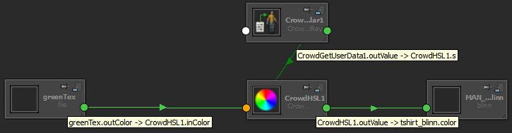

Shading Graph Integration
This shader can be used to feed a color attribute of any other shader. The output attribute of this shader is called outValue.
In the following example the Crowd HSL Shader has a texture connected to its In Color attribute. Its Saturation attribute is fed by a GetUserData shader and its output is connected to the Color attribute of a Blinn Tshirt shader.
