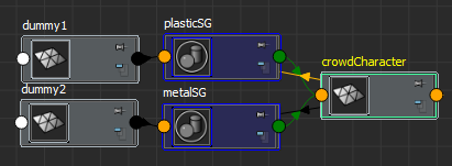

To force Renderman to export the Shader Groups which are part of the meta-Shader Group, on their own as well, you must create dummy meshes (like a Cube polygon) and assign the Shader Groups as a single Material. The dummy polygon does not have to be part of the Crowd Character, it just have to exist in the scene. So when the scene (and the dummy polygon) will be translated in RIB, the dummy polygon Shader Group will be translated as it as well.
Example of dummy meshes of force plasticSG and metalSG translation
And the resulting translated RIB:
<Payload Id="plasticSG-metalSG" Label="" Source="1" Content="1">[...]</Payload>
<Payload Id="metalSG" Label="" Source="1" Content="1">[...]</Payload>
<Payload Id="plasticSG" Label="" Source="1" Content="1">[...]</Payload>
