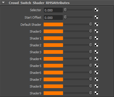

Configuration
Selector Value determining which input will be used. It is usually linked to a value which changes for each character (e.g. GetUserData), hence creating the diversity
Start Offset Value substracted from the selector value when choosing the shader. It is used to create chains of Switch Shaders when more than 10 inputs are needed
Default Shader Default shader to use if no shader corresponds to the Selector value
Shader 0 to 9 Input shaders/textures slots corresponding to the Selector value (e.g. if Selector value is 0, Shader 0 will be returned as output)

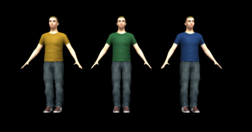

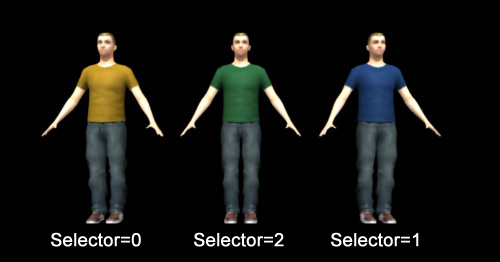

In the following example the Crowd Switch Shader has 3 textures connected to its 3 first Shader slots. Its Selector value is fed by a GetUserData shader and its output is connected to the Color attribute of a Blinn Tshirt shader.
At render time, Entities having this Blinn Tshirt shader listed in their Assets and a correctly defined Shader Attribute, you get the following result:
