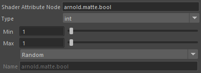

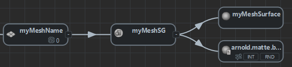

The Matte attribute can be set on a per mesh basis using the Renderer Attributes:
Example: enable the Matte flag
