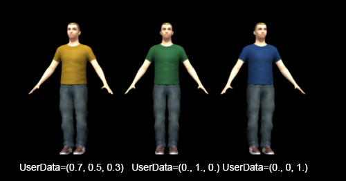

Result of a Get User Data Vector Shader combined with a Surface Shader
and different user data values.

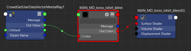

This shader can be used to feed a vector or color value of any other shader. The output attribute of this shader is called outValue.
In the following example the GetUserDataVector shader directly feeds the Color attribute of a Blinn Tshirt shader.
The Crowd Get User Data Vector is configured to read the parameter randColor as seen in the figure above.

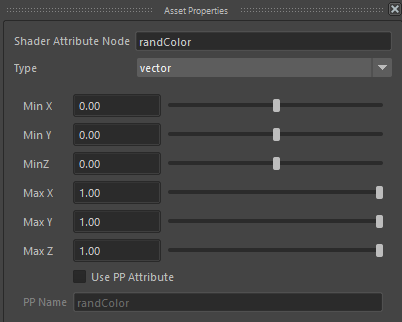

In the Character Maker Geometry Tab, the Tshirt Shader has a vector Shader Attribute named randColor which will have a random value between 0 and 1.0 for each vector component (X, Y, Z). Notice that this value can also be controlled with a ppAttribute.
Random vector Shader Attribute values
At render time the t-shirt has a random color, as shown in the example above.
