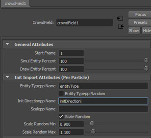

Last but not least, the corresponding Per Particule Attributes Names should be filled in the Crowd Field
Entity Typepp & Init directionpp fields on a Crowd Field
