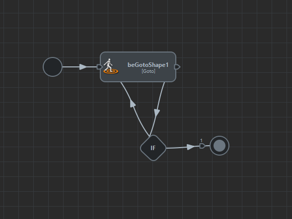

Well, because they reached their target! If you want them to select another target and keep moving, you need to create a loop around your Goto Behavior
First put your Goto Behavior in a container, and place this container in the Parallel operator.
Then, double-click on the container to open it, and use an If Operator operator to create a loop. Notice than the If operator have different output arrows. Make sure that you plug the Goto Behavior to the right one (you can check the logic by selecting the IF operator and opening the attribute editor).

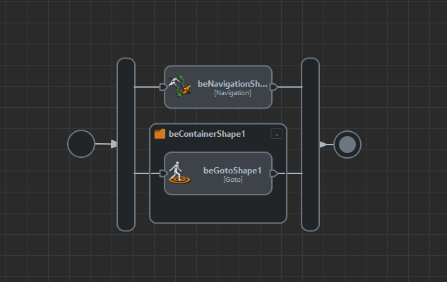

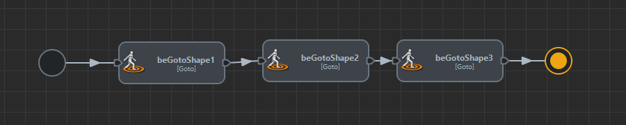

Note that these Goto Behaviors must be embedded in a Behavior Container which is played in Parallel with a Navigation Behavior. See Dual Behaviors Handling.
Example of a check point trajectory

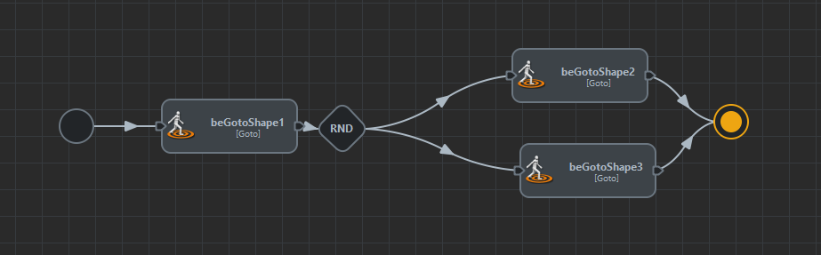

Example of a split of a group of Entities

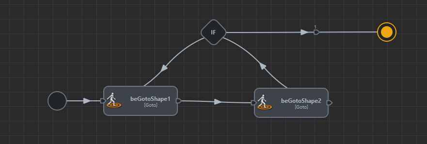

Example of a loop around two targets

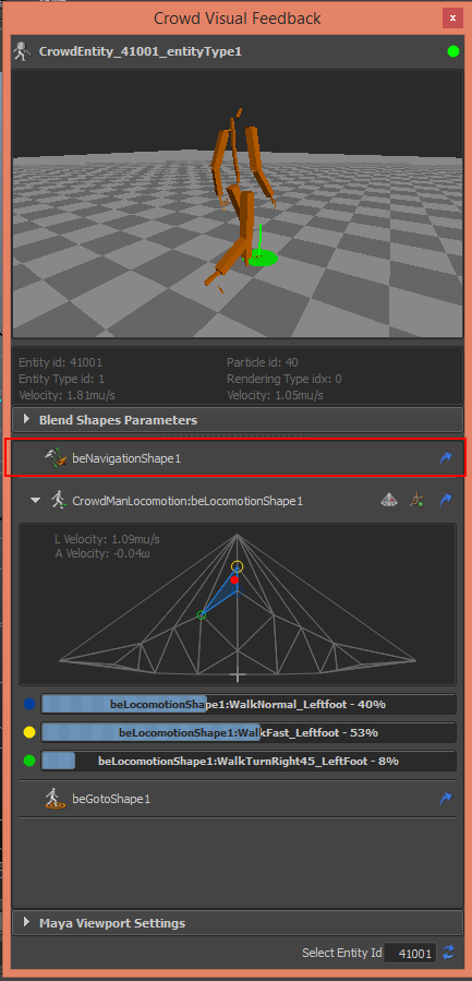

To quickly check if your characters are playing a Navigation Behavior or not: Just click on one of your characters and look inside the Crowd Visual Feedback.
