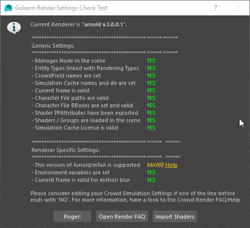

Why is the crowd not appearing in my render?
To be able to get good performances Golaem Crowd characters are not real Maya geometry. They are rendered with procedural plugins for your renderers, called by proxys/standins. These plugins are loading a Golaem Crowd simulation cache and handling the geometry to your renderer.
To check if everything in your scene is correctly setup for the procedural rendering to work, you should check your render settings.
Go to the CrowdRender menu (in the Rendering menu mode), and select "Check Render Settings".
If one of these lines show a "NO", you should first correct the associated setting before trying to render.

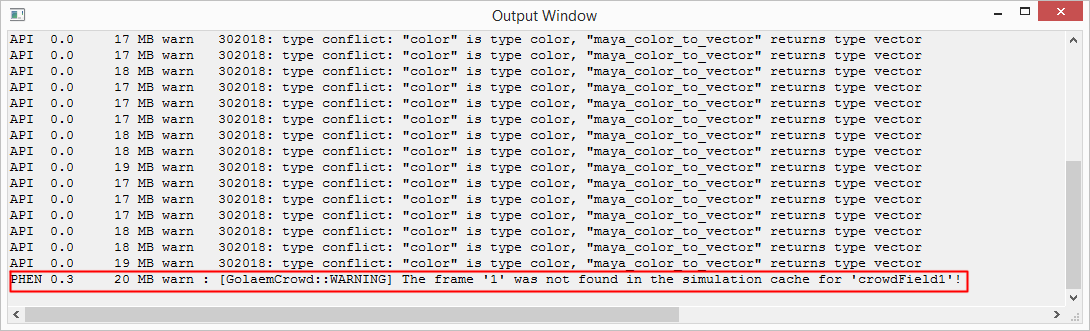

How do I check for render errors in the logs?
If you created a proxy and are using the right renderer, Golaem Crowd should output some errors or warnings in the script editor if something goes wrong,.
Just open it and check if Golaem Crowd reported something after you clicked on render.
Note that errors are often not outputed in the script editor but in the Output Window (because of the way some renderers works).

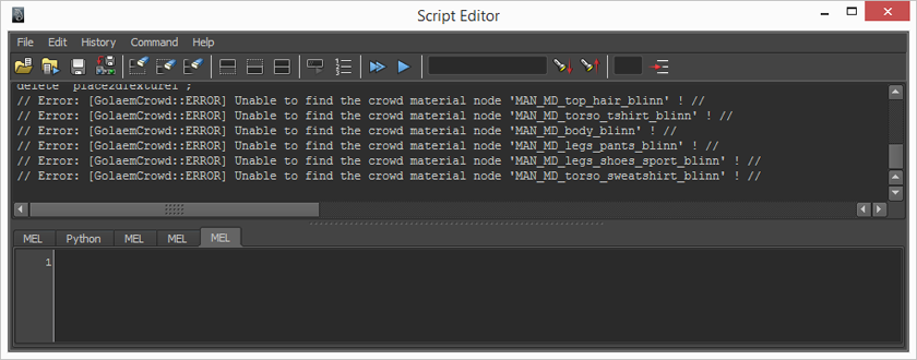

Why are all my characters orange?
It means that your renderer cannot find the Shader Groups / Shaders referenced (by their name) in the Character Maker
Usually, all you have to do is to import the Maya scene containing your source characters with all shaders in your scene so that your renderer will be able to find them (using the Crowd Render Menu / Import Shaders).

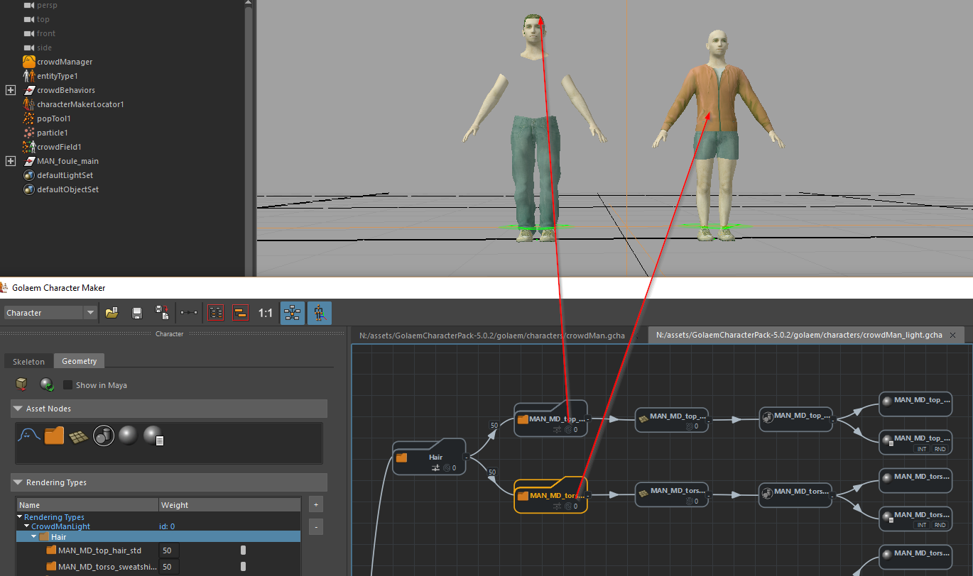

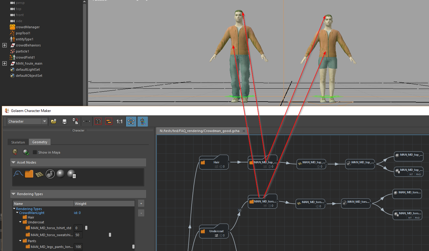

Why do I see only few parts of the geometries?
An Assets Group represents a category of assets for the Character: tops, pants, hair styles, and so on. When an Assets Group contains more than one Mesh Asset, it means that when generating a character, one and only one Mesh Asset from this group will be chosen among them, which could lead to missing parts of geometries if you did not organize them correctly.
If your assets are not related and should/could be both shown when rendering your character, put them in different Assets Groups.
Note that if an Assets Group contains the Empty Mesh Asset, this means that the character has a chance to have no Mesh selected among the Meshes in that Assets Group.
Hairs and sweatshirt being in the same Asset Group, only one of them is chosen for each character.
The same character where hairs and sweatshirt have been put in different Assets Groups.

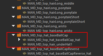

In some cases, you want various assets to be treated as a whole and always be together (e.g a T-Shirt Mesh + Arms Mesh or a Cap Mesh + a Hair Style Mesh). It is the role of the Mesh Asset to contain one or more meshes and guarantee that all the Meshes it contains belong together and will either all be present or absent from the character.
An AssetGroup enabling to randomize hair styles, some of which (in red square) are composed of several meshes

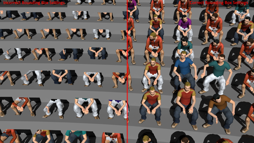

Why are my characters cut, like a Picasso?

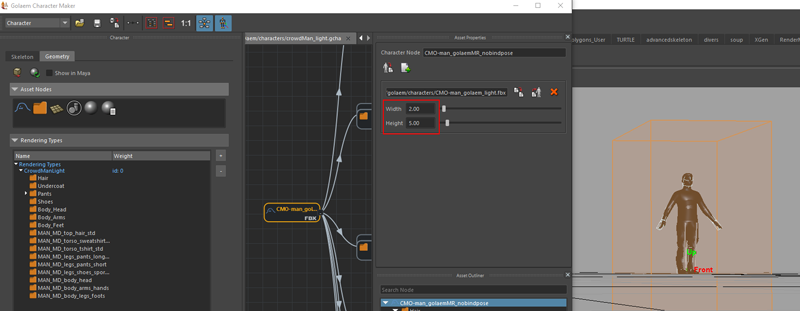

In order to optimize the rendering time, starting from Golaem Crowd 2.0, you need to specify a bounding box for your character when exporting your character fbx from the Character Maker.
Open the asset manager and select the geometry group. You can see a Bounding Box property. You can adjust the size of this bounding box in the Asset properties of your Character node and check it in the viewport.
Note that you should set this box big enough so that when your character take a different posture (e.g. raise his arms in the air), his whole body is still inside the box

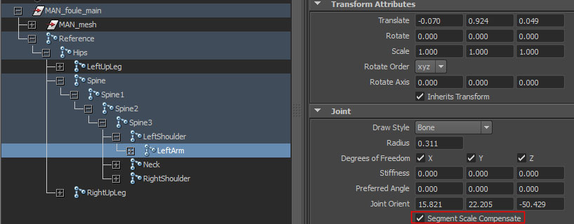

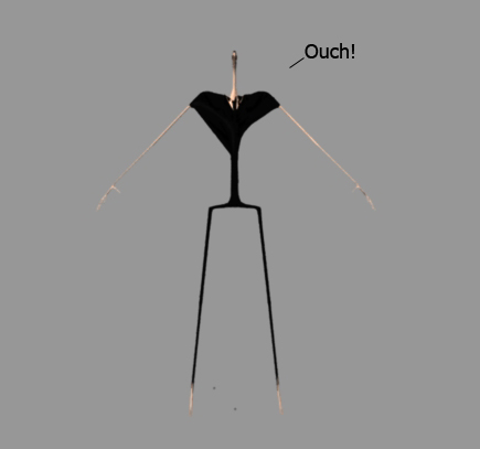

Why are my characters deformed when I render them?
It is probably because "Segment Scale Compensate" is activated on some bones. When Golaem Crowd scale it to fit your simulation, Crowd Field or Entity scale, the scale is applied twice.
You should import you geometry file (.fbx), make sure no extra-namespace has been added, uncheck the "Segment Scale Compensate" on all bones, and reexport it.

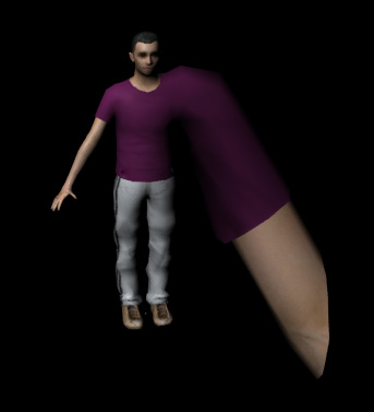

Why is my character exploding in funny way at render time
Have you check your character's joint hierarchy? This issue usually happens when the root of your character is under a group already scaled. All the nodes above the root bone (transforms, controllers) should have a identity scale (1., 1., 1.). Also please check if Scale Compensate option is not activated on some bones as described here. Once Scale compensate is disabled on every joints and the parent group is scaled back to 1,1,1 don't forget to export back your Character Geometry ! Please refer to this documentation page for more information about character prerequisites.

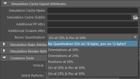

Why my Simulation Caches are flickering when replayed in Maya?
When exporting animations with wide orientation variations, you may experience flickering when replaying the Simulation Caches in Maya. This is due to the fact that, by default, Simulation Caches are compressed using quantization and some data get lost when being exported. One can disable Cache compression for this use case by changing the Bones Quantization attribute in the Simulation Cache Export Attributes of the Crowd Manager Node:

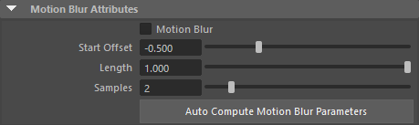

How can I get and customize Motion Blur?
The Crowd Render Proxy node provides a Motion Blur panel to configure the motion blur aspects. To configure the Crowd Render Proxy node motion blur attributes based on the current renderer motion blur attributes, you can use the "Auto Compute Motion Blur Parameters".
Obviously, it only works the motion blur in the render settings of your renderer is enabled as well.
