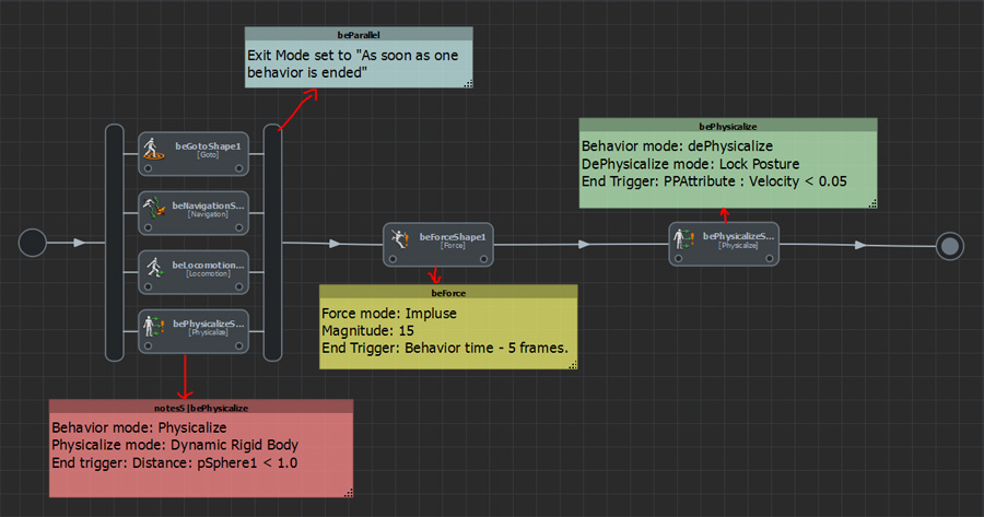

Always remember that the Physicalize Behavior set the physics mode when it stops. When creating a physics setup it is really important to check that all triggers are set correctly. The easiest way to check if triggers are correct is to select a character in the viewport in order to activate the Visual Debug and open the Behavior Editor to see which behaviors are currently running or not.
Here is how to setup the physics in 5 easy steps to set the entities flying.
- Make them move using either Locomotion, Motion , Navigation... behaviors.
- Add the Physicalize Behavior in parallel with the current motions.
- Add a end trigger to start the physics and make sure the Parallel operator will stop as soon as one behavior ends.
- Add a Force Behavior after the Parallel Operator and do not forget to set its Stop Trigger
- Add a Physicalize Behavior set to dephysicalize and set its Start Trigger condition

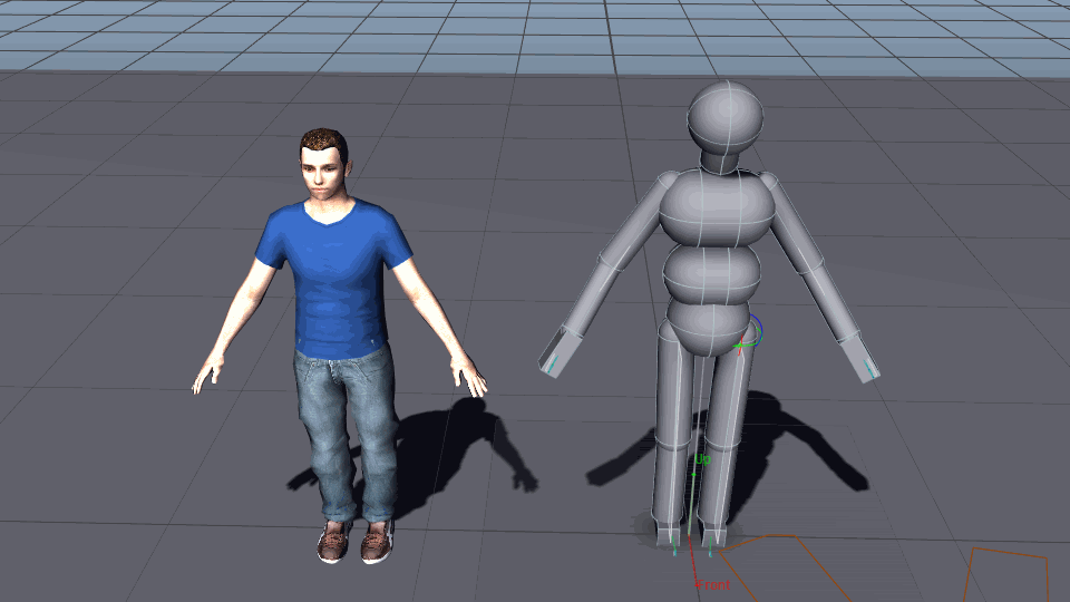

What are the best practices for customizing physical shape?
The Character Maker auto-computed physics properties do not always yield the best results, so it's better to spend a little time customizing them.
Check the complete tutorial about how to customize Physics Properties, Shapes and Angular Limits.

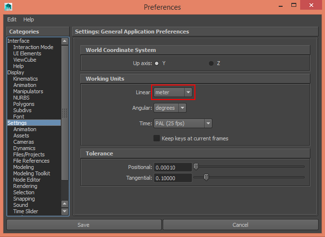

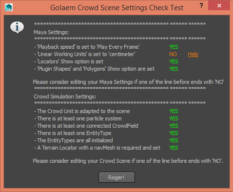

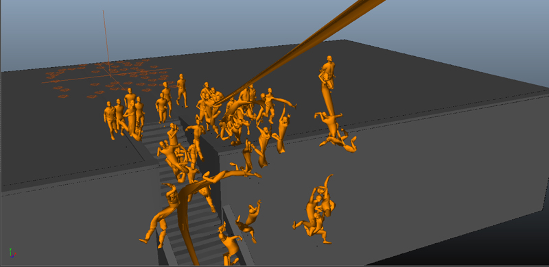

Why does my characters explodes in a wicked way when physicalised?
Have you clicked "Check Scene Settings" in the Crowd
shelf
Your linear working unit may not be set to centimeter.
Always remember when using Golaem that it will only works in this linear unit. When using another unit the simulation results might be totally weird due to extreme physics values applied to the characters.
Go into your scene preferences and change your working unit to centimeter. Do not forget to rebuild your simulation (CrowdManager , CrowdField and Terrain)

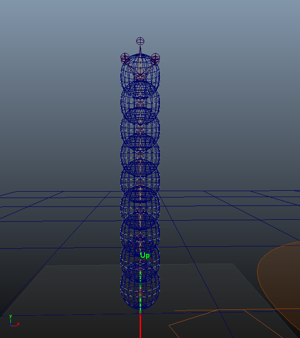

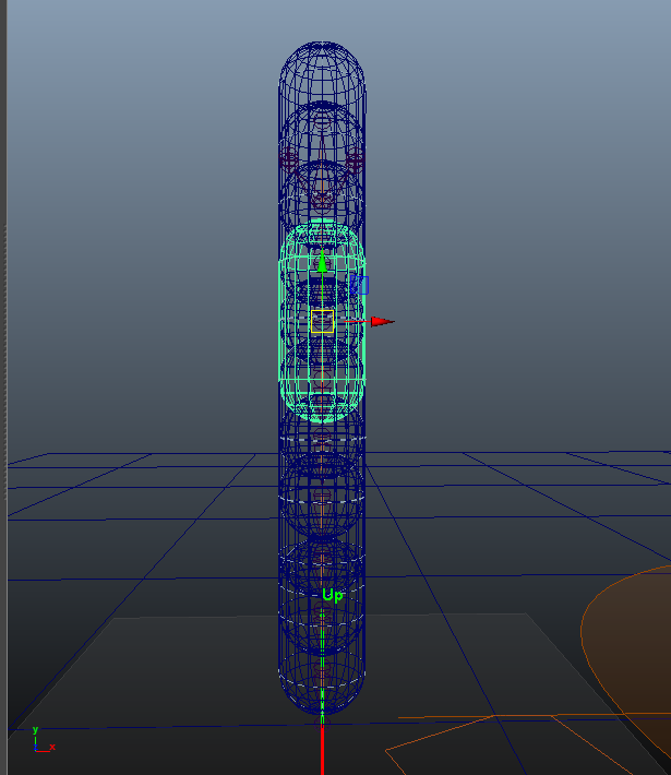

Why does my character go crazy when physicalised
Have you checked your character's Physics Shapes? Maybe your character has many physicalized bones which are overlapping, which results in physics instability.
Edit your character's ragdoll so each Physics Shapes overlaps with their direct neighbors only.
Your character should now fall naturally.
