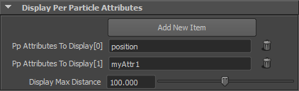

Each Entity Type lets you previsualize Entities simulation in real-time in Maya's viewport. It also supports multiple PPAttributes display. In the Entity Surface Shape Attribute Editor / Display Per Particle Attributes panel, you can add the PPAttribute Names to display:
And in the viewport:

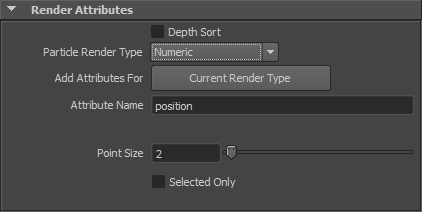

With Maya
Maya also offers a way to visualize particles as a Numeric Attribute. However, it only lets you display one PPAttribute in the viewport. In the particle system Attribute Editor / Render Attributes panel, switch the Particle Render Type to "Numeric", press the "Current Render Type" button and fill the Attribute Name field with the name of the PPAttribute to display:

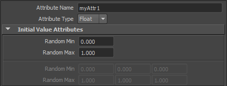

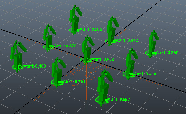

Golaem Crowd allows you to attach Entity Type Attributes to Entity Types. Each Attribute has a name, a type (float or vector) and bounds to set its initialization value. Then, when a particle of an Entity Type is created with the Population Tool, for each Attribute of this EntityType, the Population Tool creates a PPAttribute respecting the parameters.
Example: Let's attach a new Attribute myAttr1 to entityType1 with the following parameters:
myAttr1 Attribute Editor

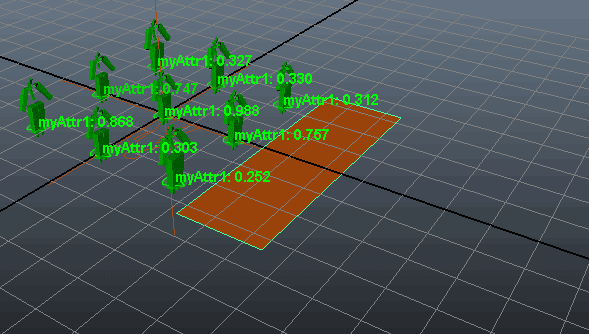

Now, each particle belonging to entityType1 and generated with the Population Tool will have a PPattribute named myAttr1 with an initial value picked randomly between 0. and 1.:
Notice that if you change a parameter of the Attribute, it is required to re-emit the particles using the Population Tool (you can use the replace checkbox to overwrite the existing particles).

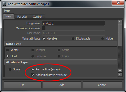

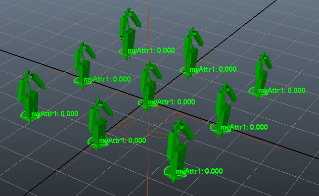

It is also possible to create a PPAttribute from Maya. In the particle system Attribute Editor / Add Dynamic Attributes panel / General:
It opens a new Window which lets you specify the name and the type (float or vector) of the PPAttribute. When creating a PPAttribute make sure you checked the "Per particle" radio button and the "Add initial state" checkbox:
By default, PPAttributes created with Maya have a value of 0.:

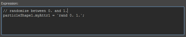

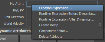

It is also possible to write a MEL Expression to set the initial value of particles. In the particle system Attribute Editor / Right Click on the PPAttribute you'd like to edit / Creation Expression...:
It opens the Expression Editor in which you can write a MEL expression:
If your PPAttribute has been created with an Entity Type Attribute, its value is set when the particles are emitted. Thus, it is also possible to edit their initial value with Maya (either the Component Editor or the Expression Editor),

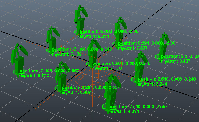

Golaem Crowd provides the ChannelOperator Behavior to easily handle and apply operations to PPAttributes during the simulation. In addition to be more efficient (in terms of performance) than MEL expressions, it can also be controlled with Triggers.
Example: Let's add an Attribute Behavior to entityType1 with the following parameters:
For each frame this behavior will be executed, it will increment the value of myAttr1 of 1. in the follwoing example, this behavior is started when the Entity in the orange zone (with the Zone Trigger) and stops when the Entity is out of the orange zone, we'll get the following simulation:

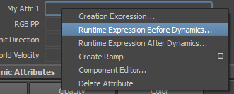

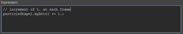

It is also possible to write a MEL Expression to dynamically change the value of a PPAttribute. In the particle system Attribute Editor / Right Click on the PPAttribute you'd like to edit / Runtime Expression Before Dynamics... (or After Dynamics if you'd like your expression to be evaluated after the Maya fields):
As the expression is in MEL code, notice that its evaluation for each particle may slow down your simulation
