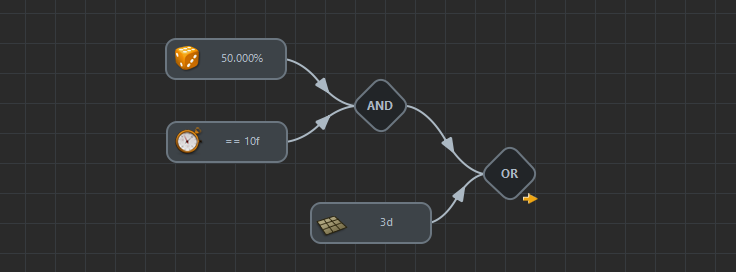

A Trigger Container containing 5 children, OR Operator marked as root Trigger
