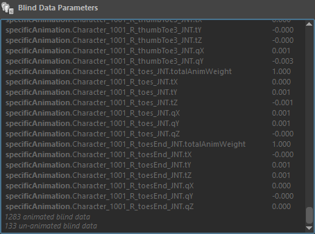

To make sure the source animation was correctly exported in blind data, it's possible to use the Motion Clip Preview tool and check that blind data channels where created for all joints translation (.tX .tY and .tZ) and rotation (.qX .qY .qZ and .qW). Note that some channels may not be showed in the Motion Clip Preview if they're un-animated:
Source animation Blind Data in the Motion Clip Preview

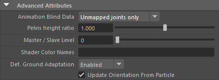

You need to activate them by setting the "Animation Blind Data" option in the Advanced Attributes of an Entity Type ( should be set either to "Unmapped joints only" or "All"):
Entity Type Advanced Attributes
When this is checked, any source animation used in Motion or Locomotion Behaviors will automatically be replayed on unmapped parts of the skeleton.
