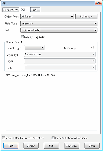

Using SET and WHERE
SET <assignment> WHERE <conditional expression>
e.g.
SET user_number_1 = 1 WHERE x > 100000
Sets user_number_1 field to 1 for all objects of the chosen object type with x coordinate > 100000

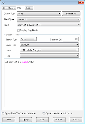

Example 1 Example
SET width = 200 WHERE width_flag = '#I'; SET height = 200 WHERE height_flag = '#D'
This will set the Width and/or Height field value for any object that has the given flag set for that field.
Example 2 Example
This will set the User Text 5 field of any nodes inside a GIS polygon in the GIS Layer "MMap1_region" to the value in the "Area" field of the GIS polygon.
See SQL and GIS Data for more information on including GIS Layers in SQL Queries.
