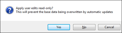

The following message is displayed:
- Click No to apply the edits in normal mode (such edits may be overridden by subsequent updates from external sources).
A strike-through is used to indicate that the rows will not be used.
Protecting edits
Edits can be protected so they will never been overwritten by external source updates.
For this, follow the steps presented in the sections above for editing time series data.
When you click Apply Edits, select Yes on the Apply user edits read-only? message instead of No.
A padlock () appears to the left of the row(s), indicating that the data is protected.
