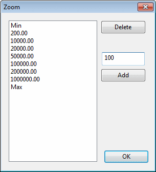

The New Level dialog is used in InfoWorks ICM to add custom levels to existing zoom/scale levels to control visibility of objects in the GeoPlan (e.g. when using themes or auto-labels).
The New Level dialog is displayed when:
- The Edit Levels button is clicked in the General Page of the Options Dialog
- A user types in a custom level in a min / max box for visible range, provided the Show New Level dialog checkbox has been ticked in the General page of the Options dialog
