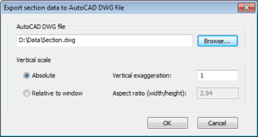

Export Section Data to AutoCAD DWG Dialog
This dialog is displayed when you:
  • Right-click on a Long Section Window, a Cross Section Window or a Section Window and select Export to AutoCAD DWG from the popup menu.
  • Select Export to AutoCAD DWG from the Section menu.
Export section data to AutoCAD DWG file
A location to which to save the files can be typed into the AutoCAD DWG File box. Alternatively the Browse button can be used to display a standard Save As dialog.
The Vertical exaggeration box can be used to specify a scale factor. The default factor of 1 indicates that no scaling will be applied when the file is exported. The Aspect Ratio (screen width over height) default value corresponds to that of the current Long Section Window , Cross Section Window or Section Window .
