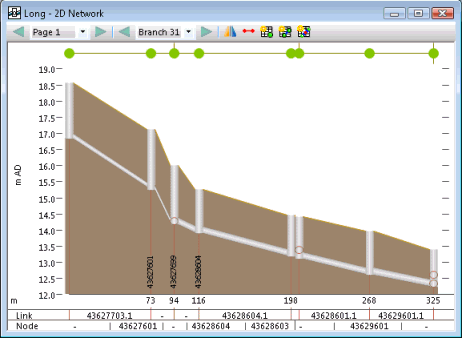

The Long Section window is displayed when:
- The Long Section Pick (
) button of the
GeoPlan Tools Toolbar is clicked and a long section subsequently picked on the GeoPlan.
- The New Long Section (
) button of the
Window Toolbar is clicked.
- If network objects have been previously selected on the GeoPlan, these objects will be displayed on the Long Section Window.
- An empty Long Section Window is displayed if no network objects are selected on the GeoPlan. Select the desired objects on the GeoPlan, then right-click anywhere inside the empty Long Section Window and select Create from Selection.
Refer to the Long Section Window Toolbar topic for information on the toolbar.
What is the Long Section Window?
The Long Section Window displays a cross-section through the length of a selected run of network objects. There are options for changing the way in which the long section is viewed and altering the labels that are displayed.

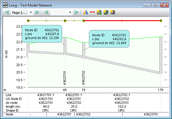

The property sheet for an object can be opened by using the Properties tool
or by double clicking on the object in the long section using the Select tool
The Section Properties Dialog allows you to decide what grid labels are displayed along the x-axis and how network parameters are represented in the view.
Custom Labels may be added to the view by use of the Label tool
