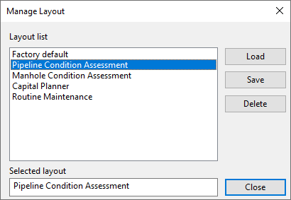

Manage Layout Dialog
This dialog is displayed when you select the Layout
Manage layouts option from the Configuration menu on the
Object Properties Window Toolbar.
It is used to manage database layouts for the Object Properties Window. It allows you to select a layout to be loaded, saved or deleted.
Dialog description
Item |
Description |
Layout list |
A list of all defined layouts. When a layout is selected from the list, its name will appear in the Selected layout box. A Factory default database layout is available for selection in the Layout list box. This layout consists of unmodified layouts or factory settings for all objects in the database. |
Selected layout |
This is used to display the name of the layout currently selected in the Layout list , or to specify the name of a new layout. |
Load |
Loads the layout, whose name is displayed in the Selected layout box, from the database. Note: Loading a Factory default
will reset all local layouts back to their factory settings. Saved database layouts will not be reset. See
Using the Object Properties Window for information about database and local layouts.
| Save |
Saves the layout, whose name is displayed in the Selected layout box, to the database. |
Delete |
Deletes the layout, whose name is displayed in the Selected layout box, from the Layout list. Note that the Factory default layout cannot be deleted. |
Close |
Closes the window and saves any changes. |
