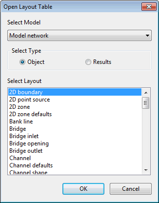

This dialog displays the layout of the Object Properties Window for the object type/result of your choice.
Example of dialog for InfoWorks ICM
The dialog is displayed when you select the Layout
Open option from the
(Configuration) dropdown in the Object Properties Window.
To configure a layout
- Select the desired network from the Select Model dropdown.
- Select the Type (Object or Results).
- Select the layout for the desired Object/Result in the Select Layout list.
- Click OK.
The Object Properties Window displays the Properties Layout for the selected object/results.

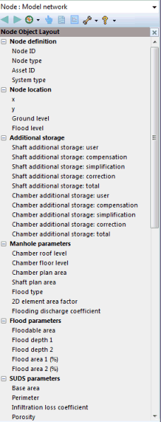

Example
Example of node properties in InfoWorks ICM
